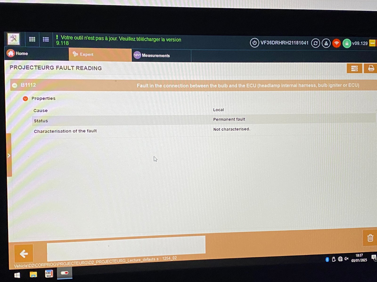

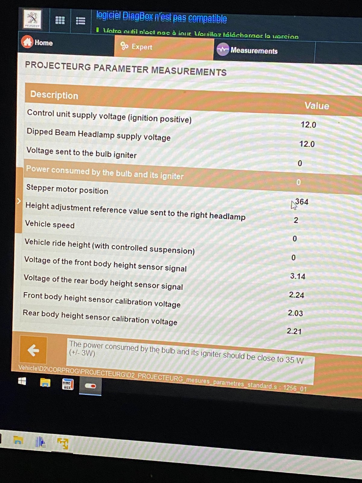

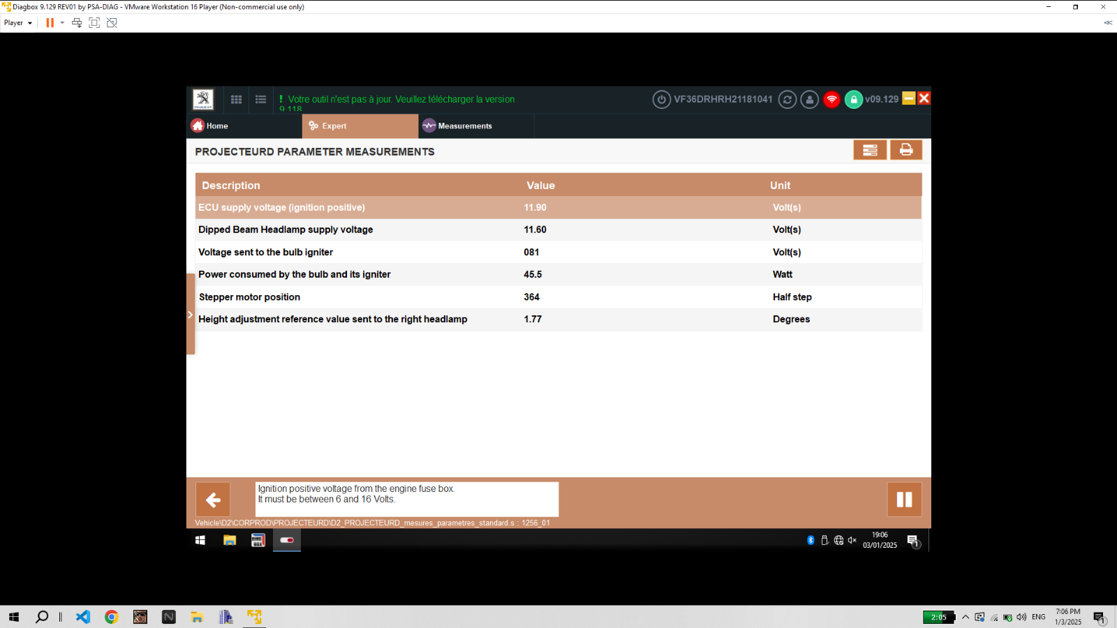

Hello, i am the owner of a 2005 407 with factory xenon. Today I changed the bulbs to some phillips ones, they worked great until i got home and turned off the car. I wanted to see how they bright they are, but when i got to the front of the car i noticed the driver side(lhd) didnt work. I changed the igniters between each other, changed the fuse, even put the old bulb back, but still nothing. I have plugged lexia in, and on the left side i got an error(pic attached). Also, i have noticed that parameter measurement works, its just that there is no supply to the igniter. Now my question is, is PROJECTEURG the left ballast or is it something else?

B1118: Left and right ECUs compatibility fault (configure): Not characterised
So with this fault have you changed anything in the BSI with Diagbox to do with the lighting? Seems it's reporting a configuration error.

sorry i edited it badly, i meant the first picture is of the error code, the second picture is the parameter measurements of the right control unit with the dipped beam on, and the third picture is of the left control unit with the dipped beam on.
the error is b1112, i have not changed anything in the configuration, it worked perfectly until tonight.

i removed the ballast, and it is looking very good on the inside, no corrosion nothing looks blown. i have put the other ballast though and that one is working, so the left ballast is broken somehow.
