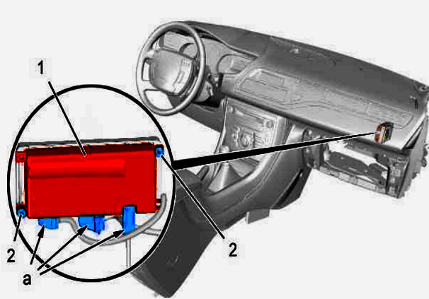

x 6959
Re: Citroen C5 X7 head unit issues
No, the services module is buried deep in the dash - on the right hand side:
If you take the end trim off the dash, you may be able to get access to it - see my post with pictures here: Installing Dash Cam C5 X7
