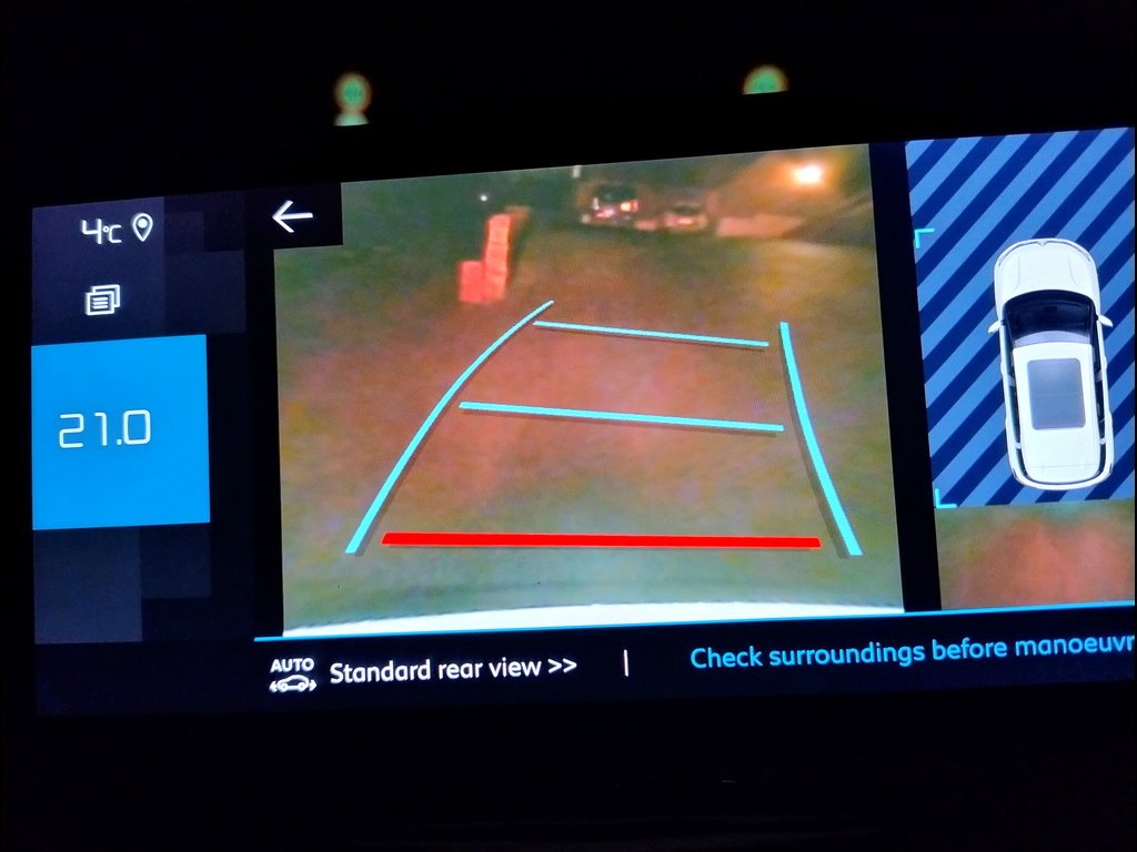

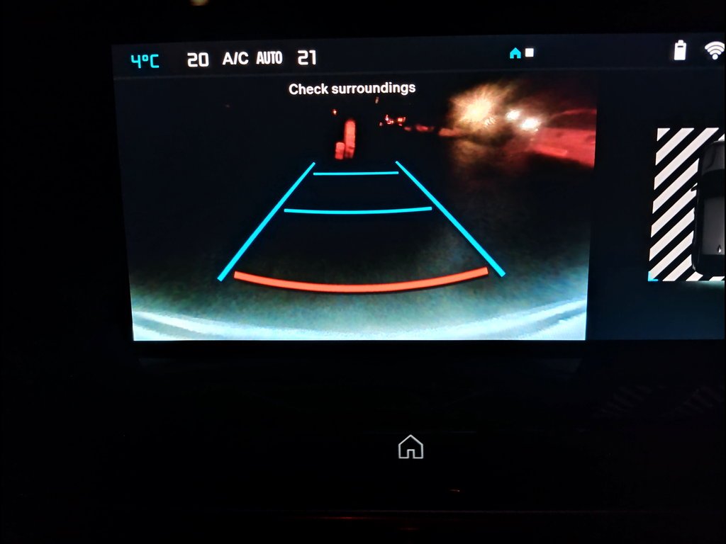

Hi Marc - yes, they're different vehicles but they have very similar camera arrangements and use the same reversing and number plate light bulbs. Here's the comparison in the same place and time, with no kind of street or parking place lighting (all you can see is house lights). Both lenses have just been wiped clean:
C4 reversing camera at night in pitch dark
C5 reversing camera at night in pitch dark
x 6945
Re: 2023 C4 reversing camera night view?
Yes, so I was just advising that the actual hardware for the cameras and the visual assistance ECUs are totally different for these models, so they are likely to have different output, as well as the vehicle heights being different (I suspect the C4 (C41) is lower than the C5 Aircross) as far as camera positioning is concerned, so that may some impact as well as the type of camera and software used.

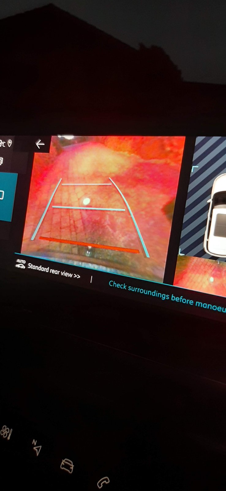

We have the 2022 C5 Aircross and the reversing camera is only good for daytime use. At night, it just shows a flash of red light. Yes, camera lense is clean.
