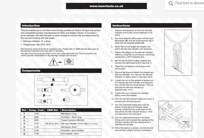

This may well help Dom:
This is the Laser Tools DTI Timing Kit:
It shows quite nicely how they are made and includes brief notes on how to use it. The guidance is NOT specific to an XUD 1.9TD but rather generic for any engine having a VE type pump.
Indeed, It would not be hard for a competent engineer to knock one up on a lathe... They would need a pump by their side to do so though...
Making one 'blind' would be tricky...

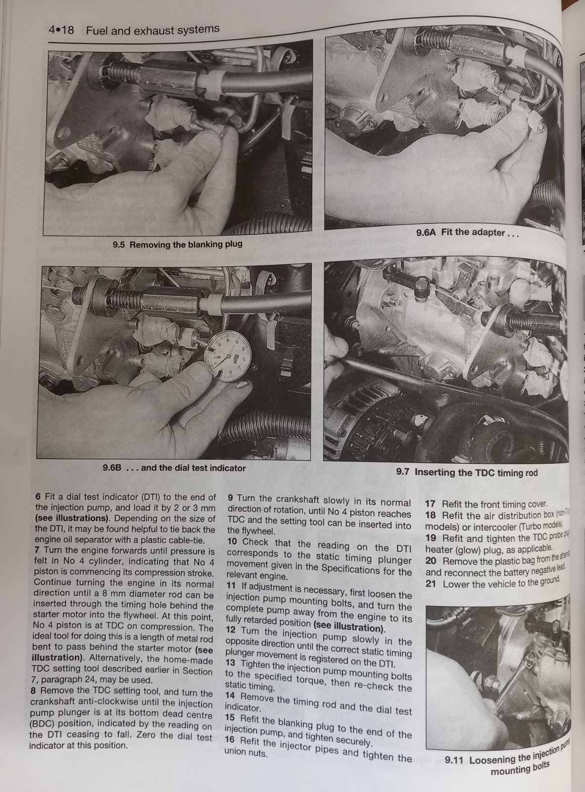

And this is is quite a comprehensive procedure from the XUD Diesel Engine BoL to time a 1.9TD using a DTI:
The setting should be around 0.66mm
You might need to do a bit of zooming on those images to make them fully readable
Hope that helps a bit...
