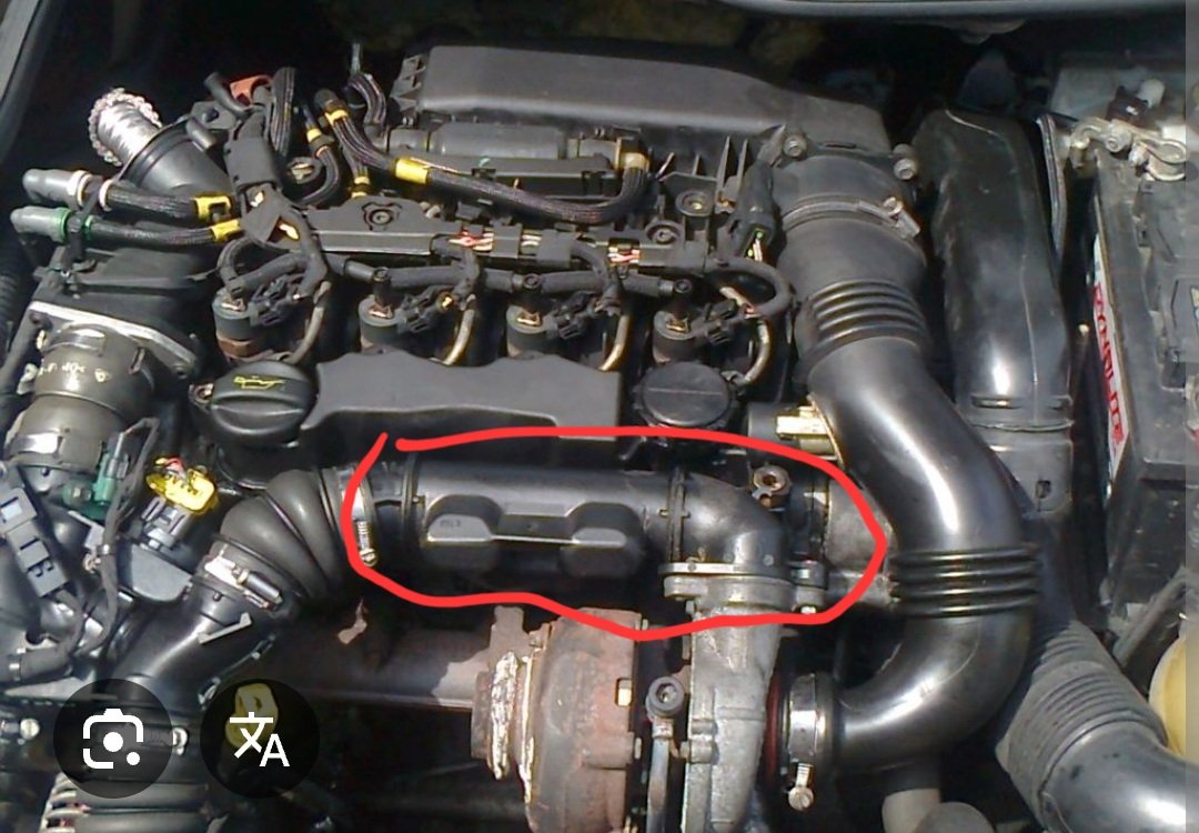

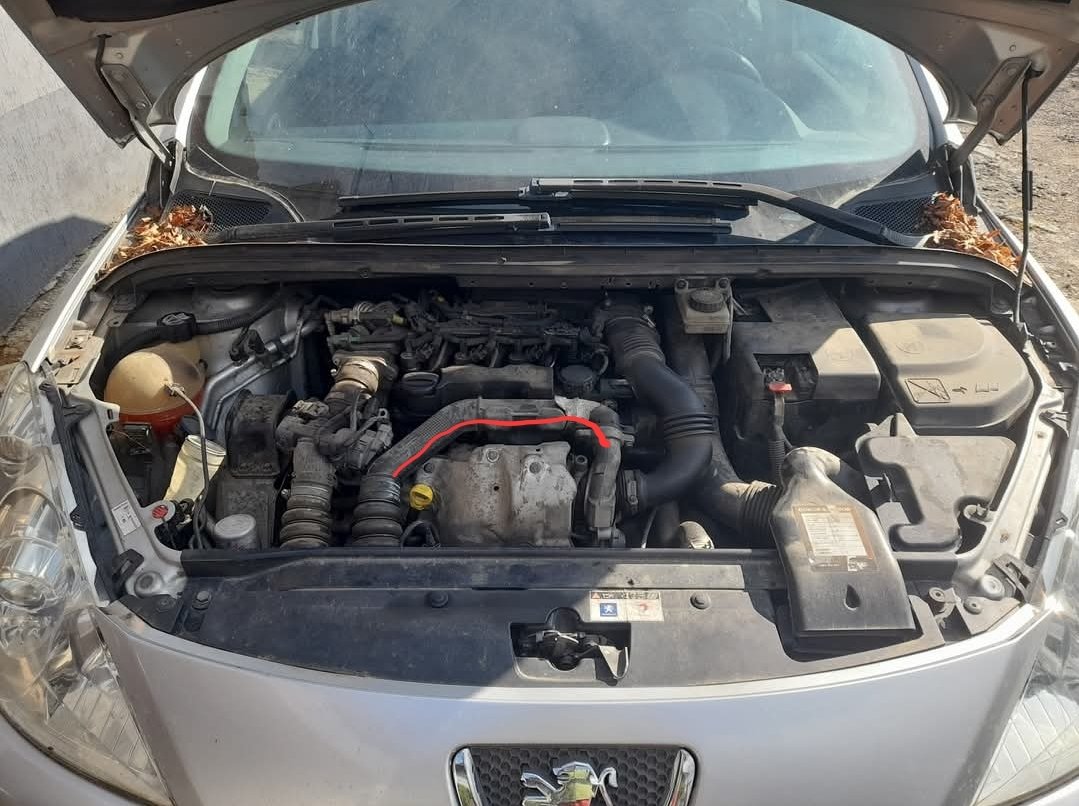

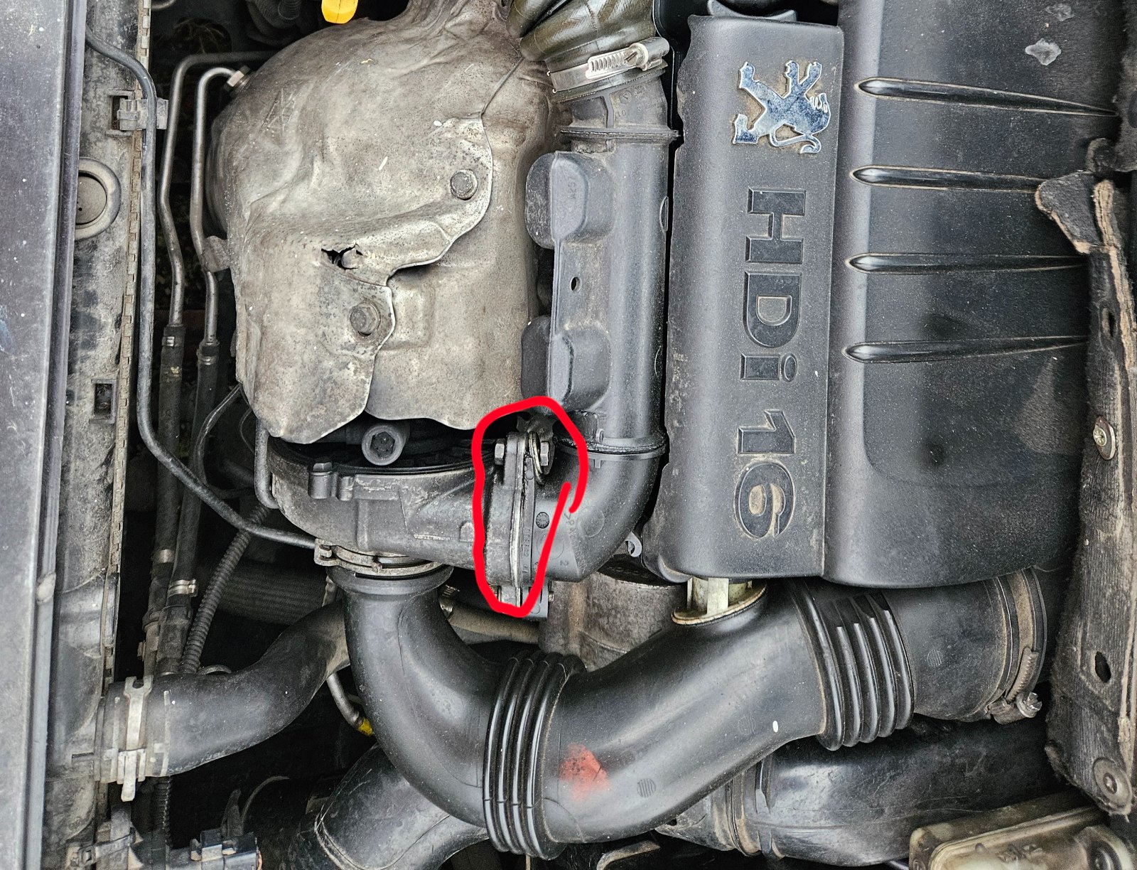

Hello everyone,I want to replace this plastic pipe because it is leaking on connection with turbo.Problem is that I can not find short pipe like on my car(peugeot 307 110hp 2006).Is there any way to seal pipe that I already have,or can I buy that long one and cut it.Does anybody know why there is short and long versions..Thank you in advance.

I fairly sure the OEM no. of your pipe is. 9653777980
They can be found online, but the price point varies hugely. Fairly cheap ones on Ebay:
https://www.ebay.co.uk/sch/i.html?_from ... 0&_sacat=0
Another option would be Hylomar Blue or any other engine-specific oil resistent sealant.
