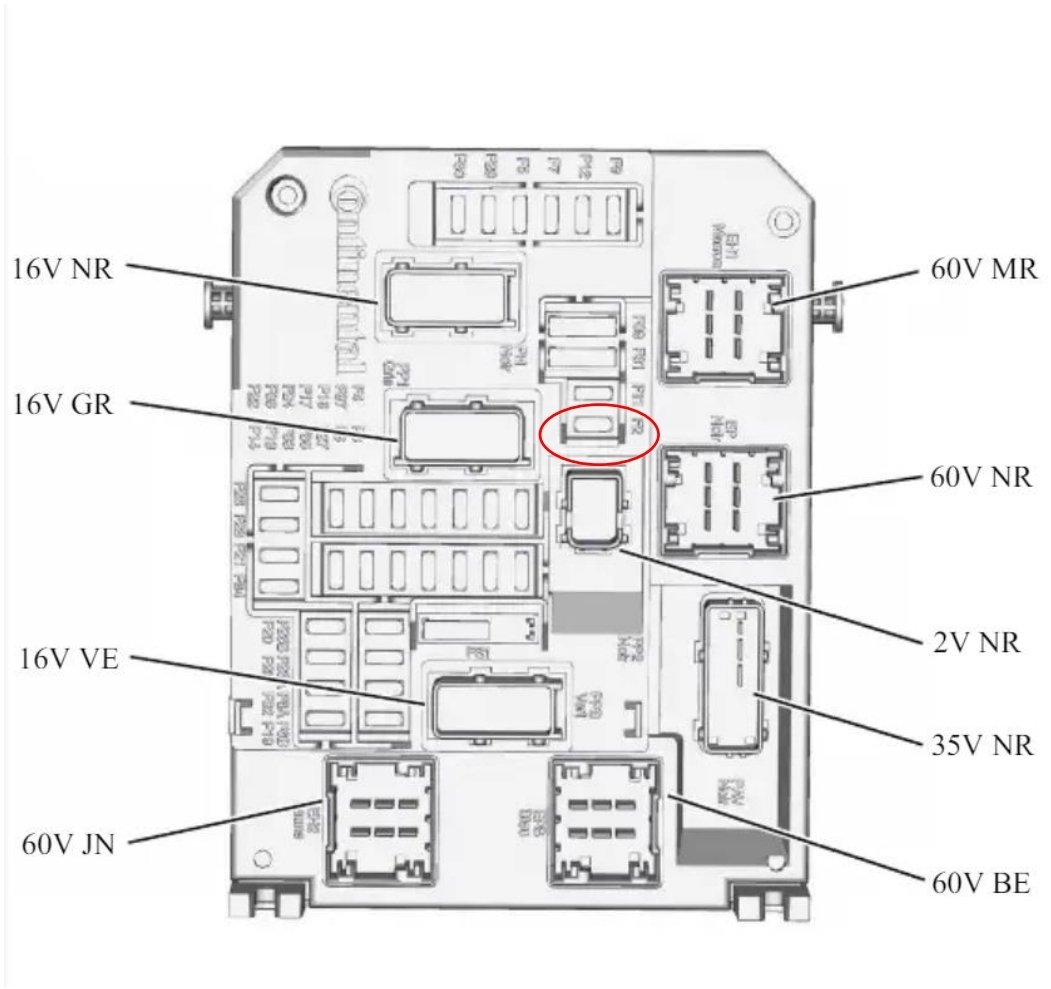

Was in Citroen in Milano few months ago for another issue, most likely this issue is connected to the start and stop system.
After removing the fuse F2 (not easily reacheable), relevant for the diagnostic socket and the central voltage retention device, the car starts to switch on with no delays (but of course with the service beep...).
Did you have any luck in the meantime?
I put the fuse back otherwise no ODB2 port connection, no service beep but delayed start is back...

Most likely it's me and you on earth having similar issue.

In case you want to try removing the fuse, that's the one. Not at all easy to plug it in and out.
It controls the diagnostic socket and the central voltage retention device, your ODB port won't work
