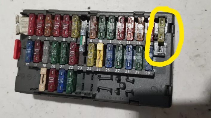

If i remember right you move this fuse across so it goes into the empty terminal next to it.

wheeler wrote: 14 Dec 2024, 18:47 If i remember right you move this fuse across so it goes into the empty terminal next to it.
What he said.
