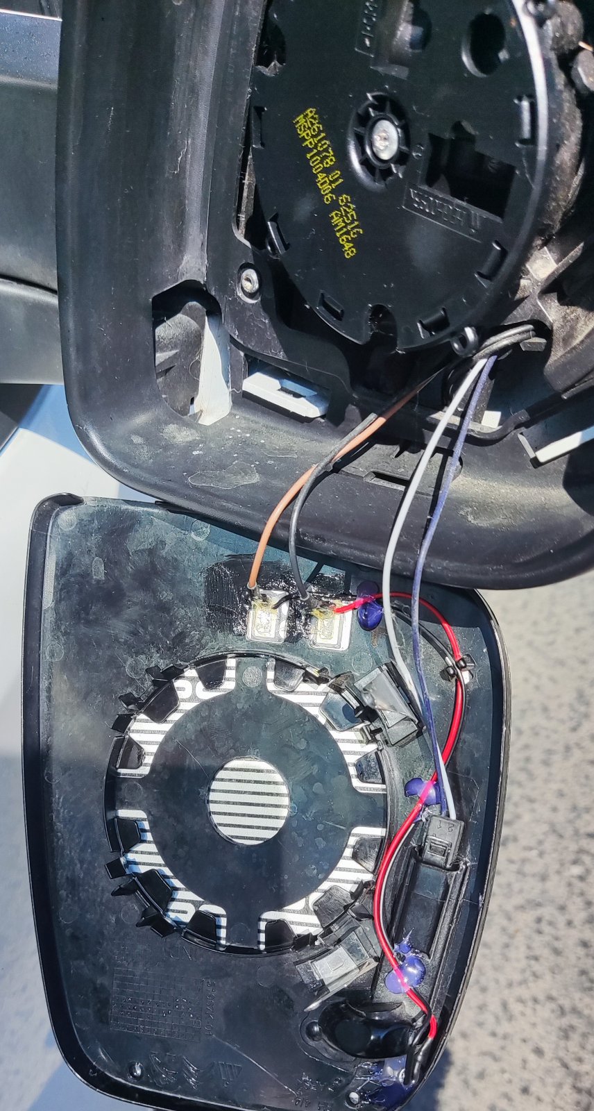

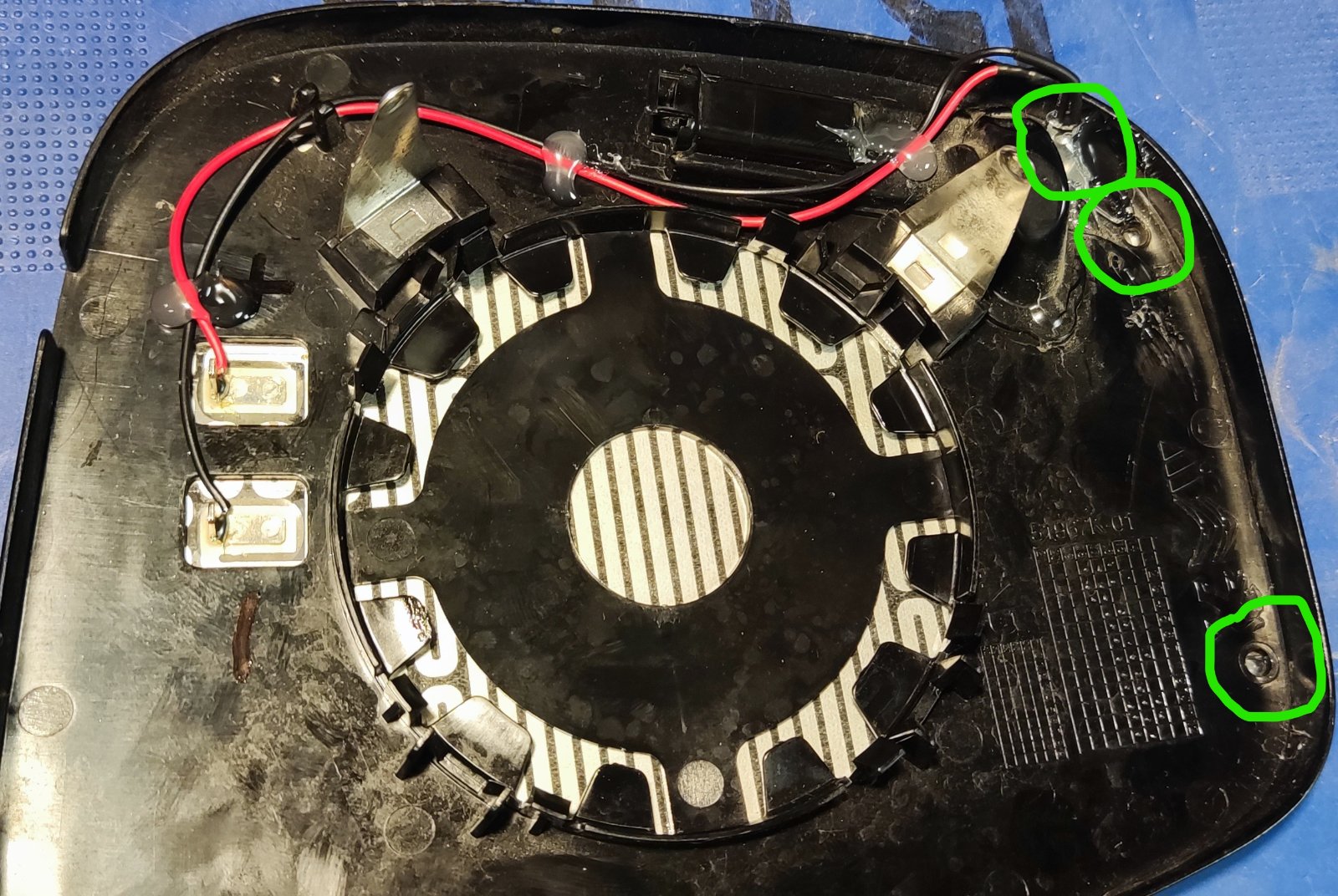

Many on here including myself have added a small LED light to the drivers door mirror connected to the mirrors heating element as most Peugeot and Citroens with a DPF fitted turn on the heated mirrors and the heated rear screen when they start an active regeneration, I think it is to do with the extra load but not sure.
Then when you notice the light turn on your aware a regeneration is taking place and can choose to continue to drive untill the light is out, it works well on my 2018 Expert van as it still completes a regeneration whilst slow and in traffic in 5 to 6 miles.
It will not indicate a passive regeneration as this is unassisted by using the heat generated by a good run.
Here are a couple of pics of my Expert door mirror.
Cheers
Bobby

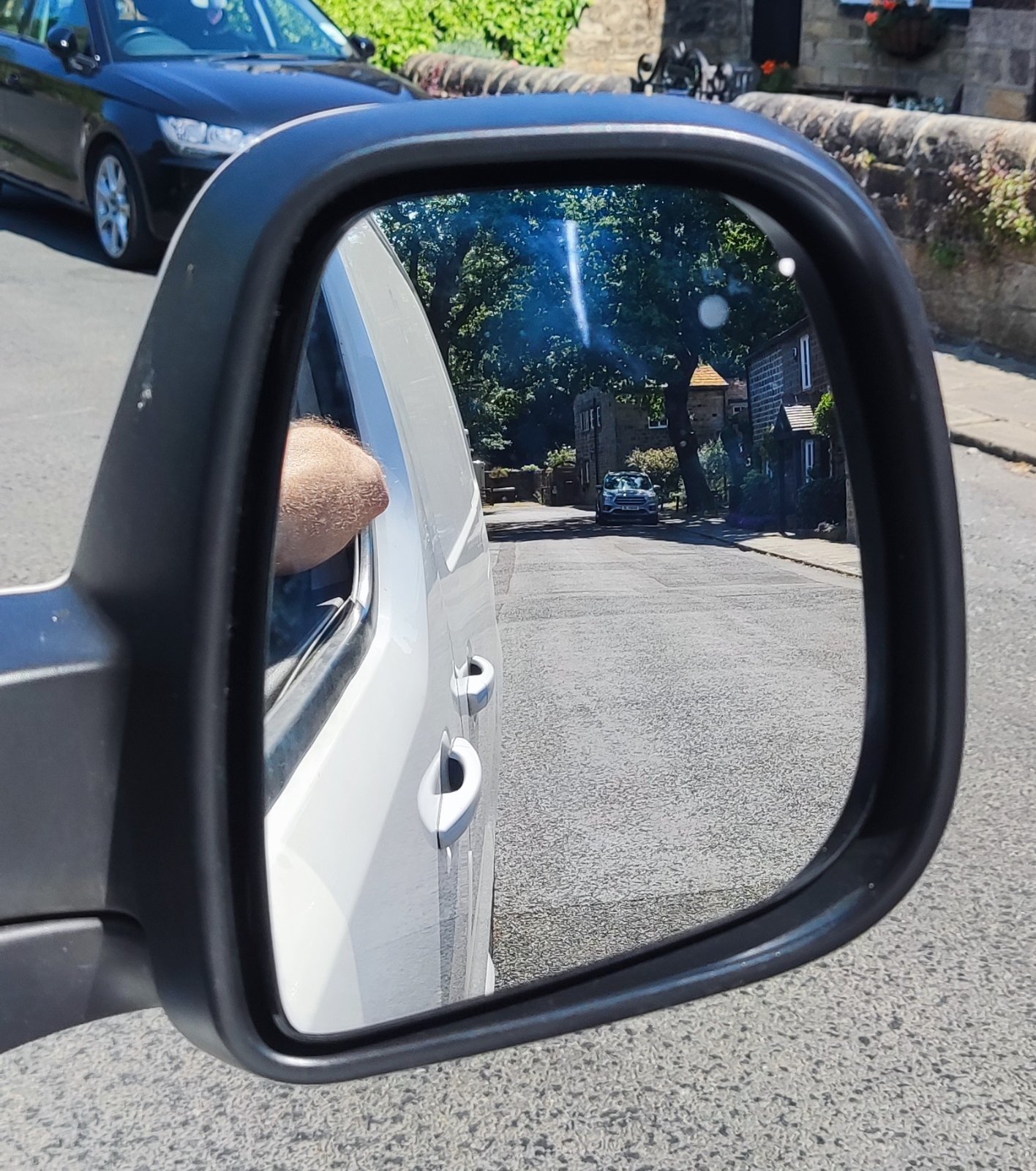

It may be my eyes, but I can't make out your LED handywork in either photo. Is it the red/black pair? If so, it's very well done Can you elaborate, I like the sound of this. Don't understand the difference between active and passive regeneration? Can one of these be self initiated?

Hi Andy, hope this helps.
An active regeneration is when the ECU gets involved, it's a similar process to a forced regeneration while on the move but not quite as aggressive. It does things such as injecting diesel on the exhaust stroke to fuel the fire in the DPF to burn off the soot collected.
A passive regeneration is at times such as a long run at 40+ mph when the heat generated from the normal combustion process is enough to raise the temperature of the DPF to burn off the soot collected without assistance.
The DPF additive fluid is added to the Diesel tank when you fill up and it reduces the temperature required to burn off the soot.
That's sort of in a nutshell but there is more to it.
Here is another picture of my Expert van door mirror with some more detail, the green highlights are where there were small round 'windows' in the mirror so I glued the LED behind one of them.
I used a white LED as I had some left from a project but it's a bit bright at night, maybe a coloured one would have been a better choice. By chance not design the LED is clearly visible to me in the drivers seat but can hardly be seen from outside the van.
Bobby

Hi Bobby againtricoloured wrote: 12 Dec 2024, 23:49 Hi Andy
Cheers
Bobby
