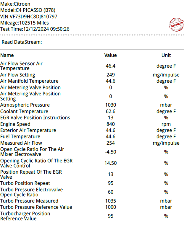

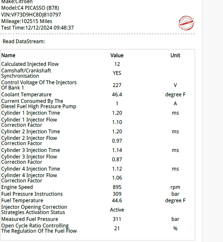

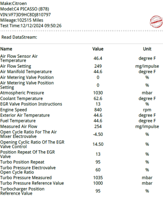

I have a C4 Picasso 1.6hdi 2013 (B78) and its recently start to have a rough idle, but seems to be running fine at speed. We notice it more when coming to a stop at lights/Junctions etc. I have had Diagbox and Think Diag on it and no fault codes but when looking at live data the Air system shows a couple of things I'd like to double check.
The air metering valve position and setting never change from 0% and the Open Cycle ratio for Air Mixer Electrovalve always stays at -4.5%.
All the other data PIDs change with revs.

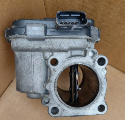

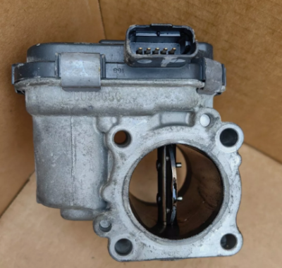

I made an assumption that the air metering valve was the 'Air Doser/Mixer Genuine 1.6 HDI DV6 Air Mixer Unit Assembly 9673534480' which is basically a motorised circular valve the diameter of the air pipes on the top left of the engine (looking from the front of the car). I tested it via Think diag actuator tests - it moved to a couple of different positions then went to default of wide open - no errors came up. I found a scrappy replacement anyway just in case and fitted it, its exactly the same.
Am I barking up the wrong tree with those 'air metering valve positions' being 0 and the open cycle ratio being -4.5% for the cause of a rough idle and that that relates to the 'Air Doser'
The Measured Air Flow fluctuates when i rev the engines so assumed the MAF is working fine (unless someone tells me the 254mg/impulse at idle is not correct)
VIN is in screenshots.

The mixer valve is only activated when a regen is called far AFAIK. I suspect you have an injector (or 2) that is going wonky. My 3008 vibrates a bit at idle, hasn't really changed in 50k miles, so I just ignore it!

The wife has a few long runs in it coming up so will get feedback from that to decide if I simply keep an eye on it for a while. (having recorded the Injector figures, I can compare at a later date) At least I now know its not a snag with that mixer so I am not chasing myself. I am fairly proficient at injector pulling/replacing/coding now so it wouldn't scare me if I needed to do it (have slide hammers and a pneumatic vibrating puller too that I used on an extremely stubborn injector in a C4 Grand Picasso a few months back)
