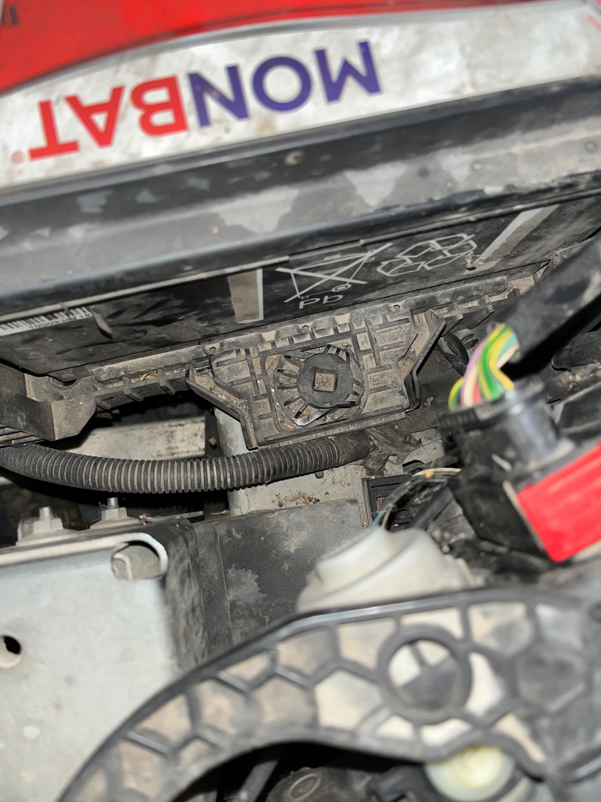

Does anyone know how to remove this plastic bit?

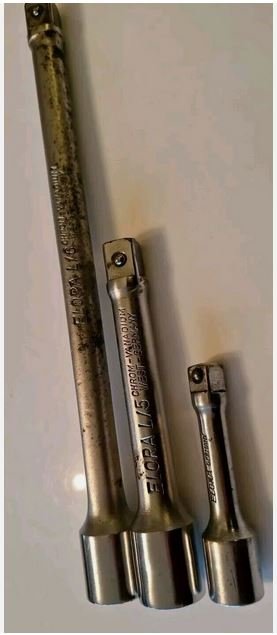

Yep, I think it just needs a 1/2" (??) extension bar on a ratchet. Put the square end of the bar in the plastic bit and turn it. Might want to check it's not a 3/8" drive though !
This time of year I'd definitely look at the battery condition - a lot of issues can be caused by a dodgy battery.

Ah cheers Bobins! I think it's the battery cuz when I just opened the door to get something out the car, the screens started to go haywire and everything was beeping and blinking. Anyway got a Bosch one, just need to find the extension bar.bobins wrote: 10 Dec 2024, 17:27 Yep, I think it just needs a 1/2" (??) extension bar on a ratchet. Put the square end of the bar in the plastic bit and turn it. Might want to check it's not a 3/8" drive though !

Take care turning that plastic thing - out only needs half a turn and can be stiff at first. Try turning it slowly to prevent breaking.
Also, ensure the ignition is turned off and remove key and leave for 5 minutes before disconnecting battery to prevent errors.
