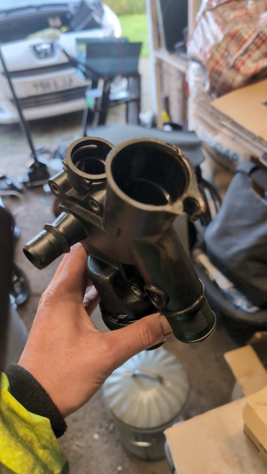

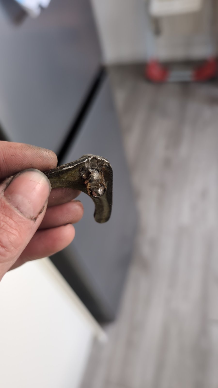

Getting the Dremel on it 😀 🤞

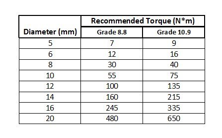

Not sure on PSA recommended torque, but this will give you the general spec
