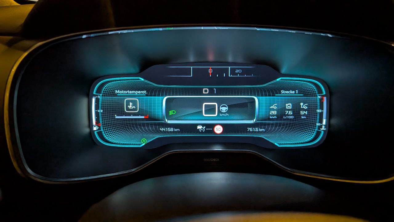

One thing I noticed this morning:
The Stop-Start engages even on a cold engine.
I left the garage (12 Celsius Degree ambient temperature) and the Stop-Start engaged on the first stop (about 20 seconds after starting the car).
It kept engaging with every stop. Here is a picture where the engine oil temp is still on "0" wheres the coolant is at "20%".
Link: https://files.bestmail.ws/C5A/photo_202 ... -14-17.jpg
This shouldn't happen? Stop-Start should only work when the engine has normal driving temperatures?
So I am wondering if a cable is connected to the battery which might be disconnected now as well?
Because I also read about tricks online where people would disconnect a cable that is attached to the battery and would tell stop-start systems the current charging status or ambient temperature.

How every I might actually be happy with stop start but I just don't understand why it turn if the engine when the ambient temperature and the engine is cold? Isn't that especially bad for the engine?
