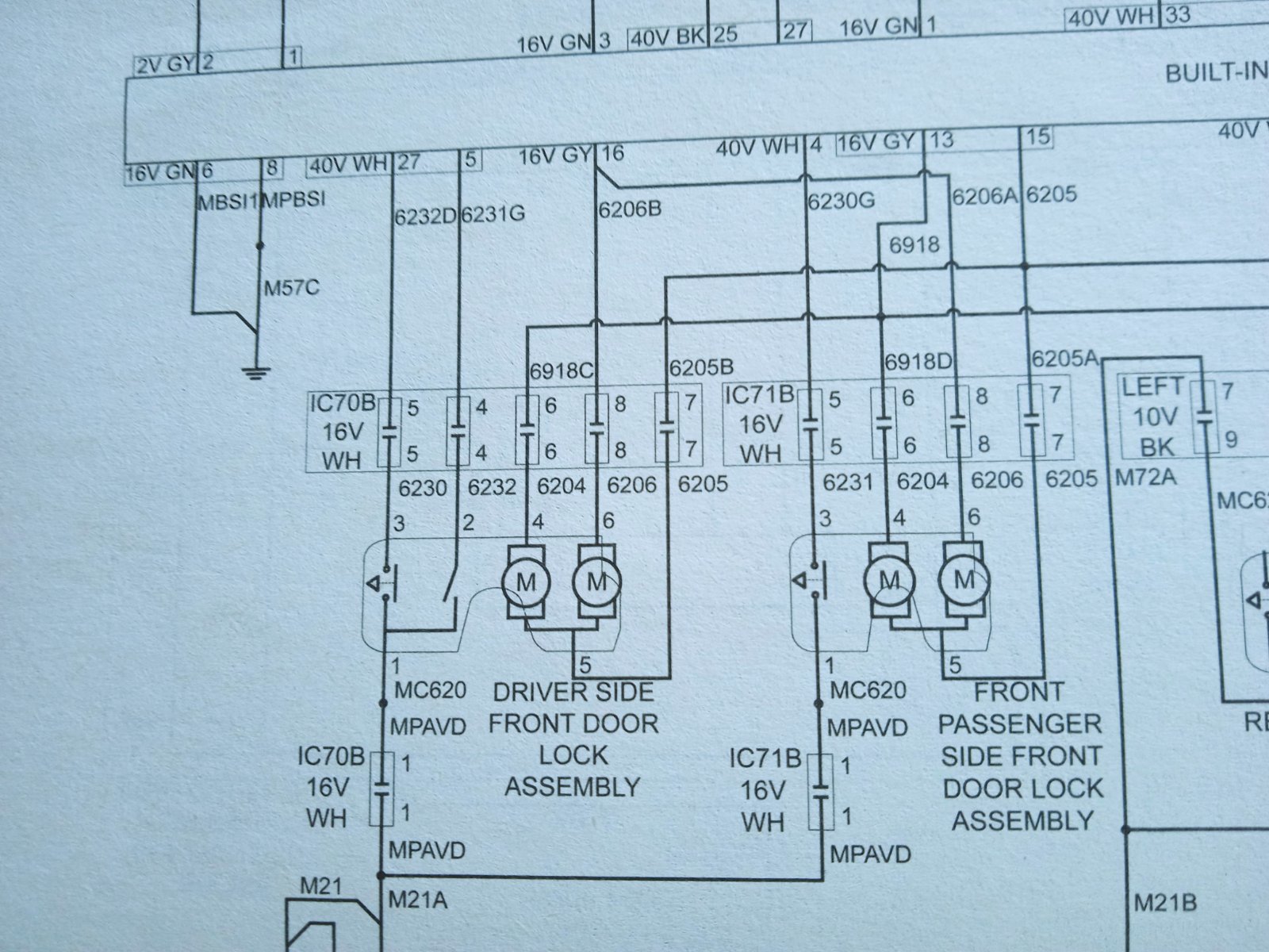

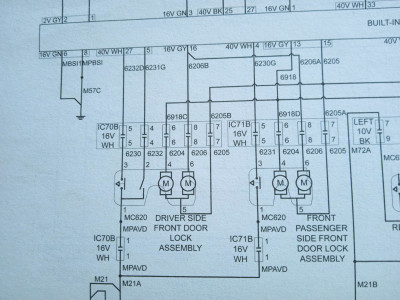

Mine is a 2010 and the wire is in the lock itself. Haynes BOLs diagram shows 5 or 6 wires depending on whether it has dead locking or not. From the wire diagram I narrowed it down to 2. Of course with it being 50/50 I cut the wrong one on the first attempt and had to re-solder it. As Paul says, confirm the lock with a screwdriver first before chopping. Only downside if you do cut the wire is you lose the interior light when the drivers door is opened but at least you can lock the van.

My nuts were were captive (don't) and I could remove the the hasp and flip it over, made no difference. My door showed as locked with a screwdriver also, and if you lent on the door. Tried ovalling the hasp holes to move it outwards, no joy. The switch in the lock was the issue I concluded so new lock mech or cut the wire. As you're in the UK with a RHD see if a tat yard has a lock. Not an option for me with a RHD in France, so cut the wire.

I don't I'm afraid but you need to take the door card off and the outside lock assembly. From memory the wire harness plugs into the lock assembly. A Haynes BOL's is useful if you can't find a You Tube video. I did take a picture of the wire diagram for mine.
Pete
