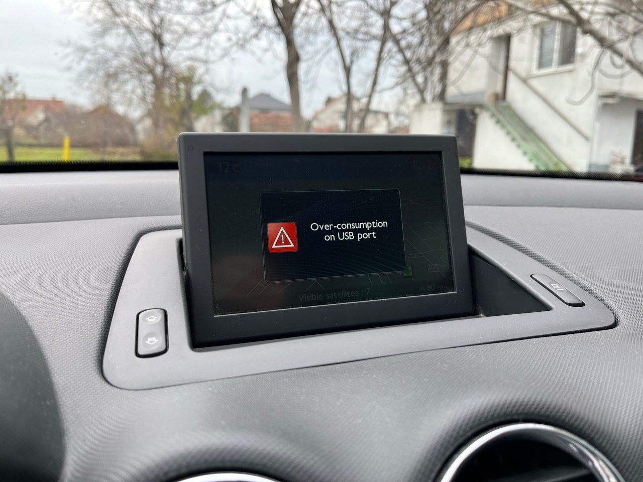

I try to use USB port on RT6. When I put any USB 3.0 memory stick in USB port I got alert message: "Over-consumption on USB port"
after few seconds I got:

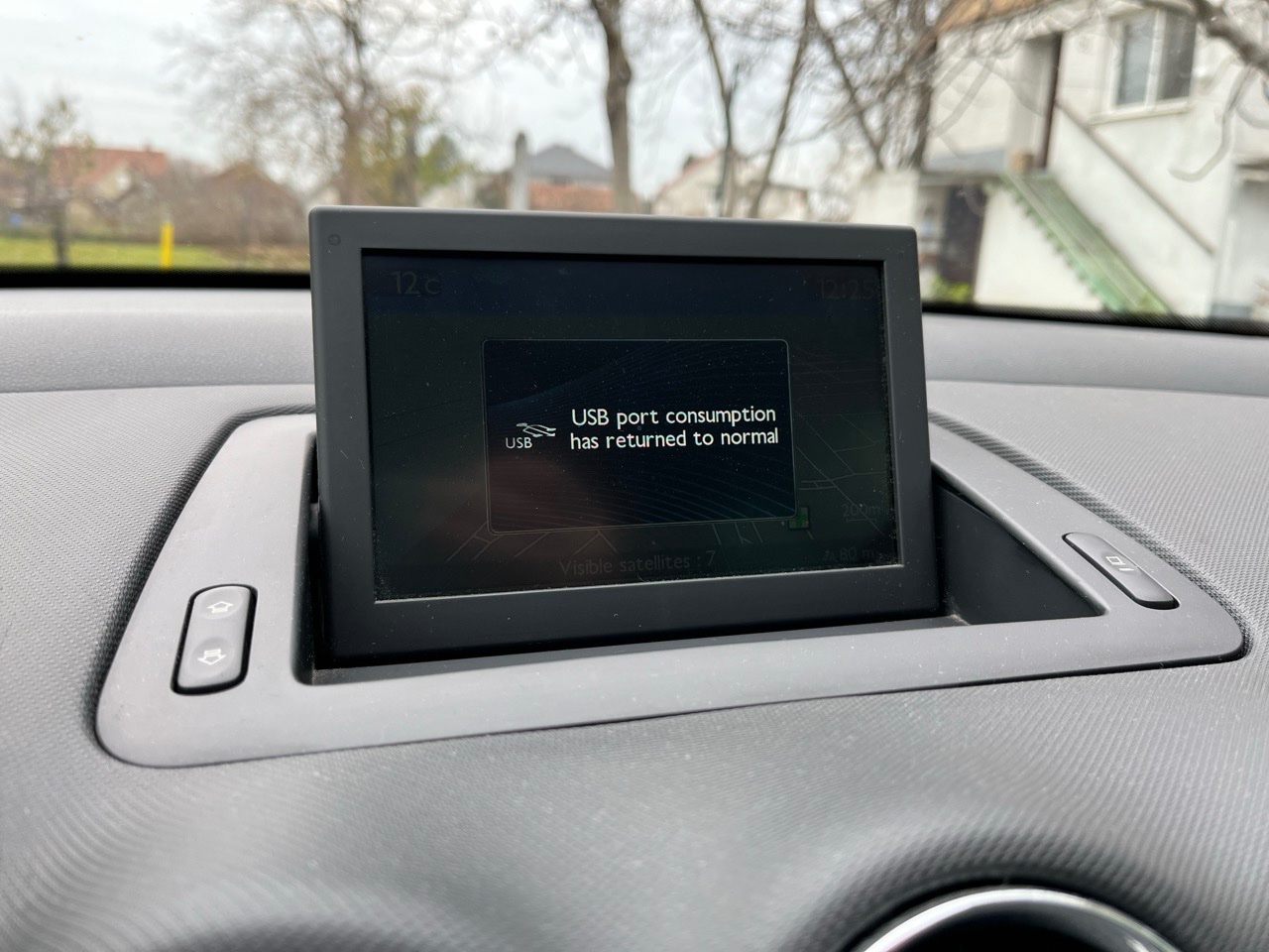

and then again "Over-consumption on USB port" and these two messages goes in loop until I pull out USB memory stick.

OK, this is the answer:
USB cable that I order and received from AliExpress was assembled in wrong PIN order!!!
Chines reverse GND, Tx -/+, 5V wires!!
I fix it and now everything works!
x 6955
Re: Over-consumption on USB port
Say no more....... cheap Chinese rubbish - these are causes of most of these errors and you risk blowing the unit if you connect these dangerous cables.
Cheap for a reason. Always use genuine cables which have build in protection.
