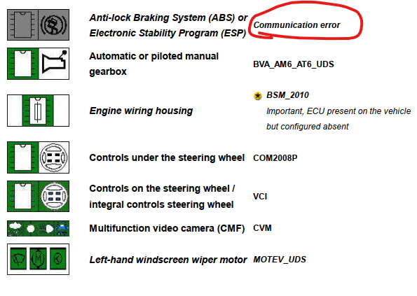

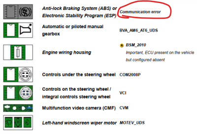

The key problem I am trying to fix for the moment is get back in communication with the ESP computer, the report is showing "no dialog"
I have had an auto electrician track the can wires etc, and all seem to be functional (not the Citroen bad wire issue..), both conductivity and the expect 2v.
There are errors, but once I can get into the ESP computer, I think a lot of these can be resolved and or point me in the right direction.
I think the ESP is working and functional. I took the car our to a paddock, heavy breaking etc, and the ABS seemed to kick in.
Googling about, am am wondering if I have a bad BSI that needs to be re-flashed, or replaced???
