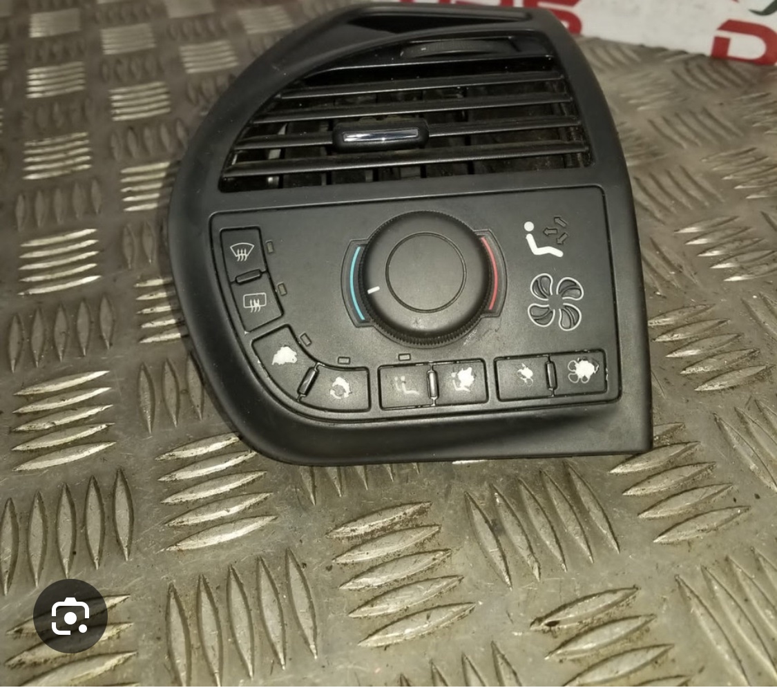

Hi all, I have recently inherited a 2007 C4 Picasso 2.0 Diesel Automatic with 42000 miles and full service history.
The problem I have is that the heater blower is not working, the lights on the panel (R/H side next to door) are all working and you can change the fan speed on the switch (green lights on display) but the actual fan is not working, does anyone have an idea of what I should be looking for?
