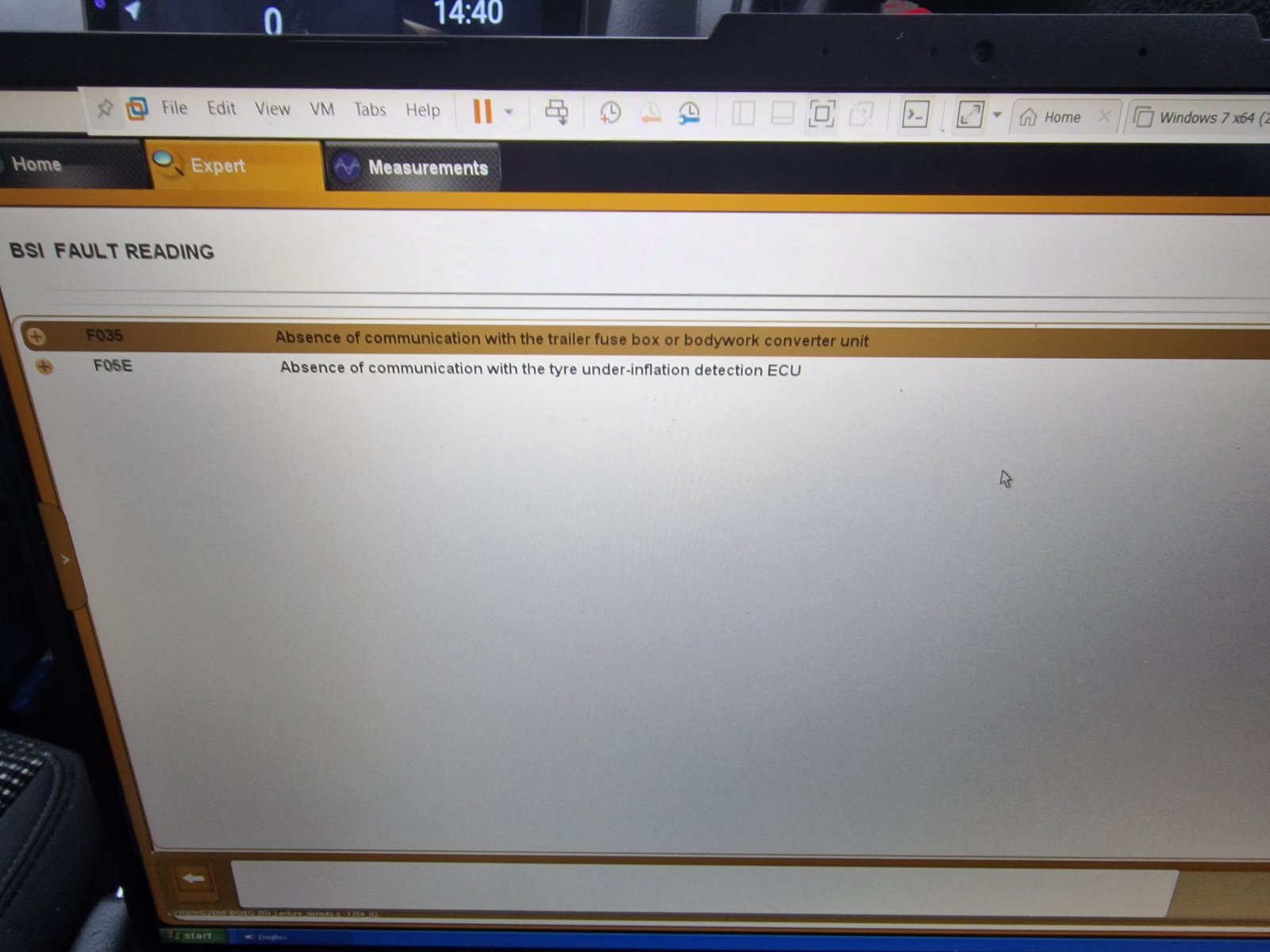

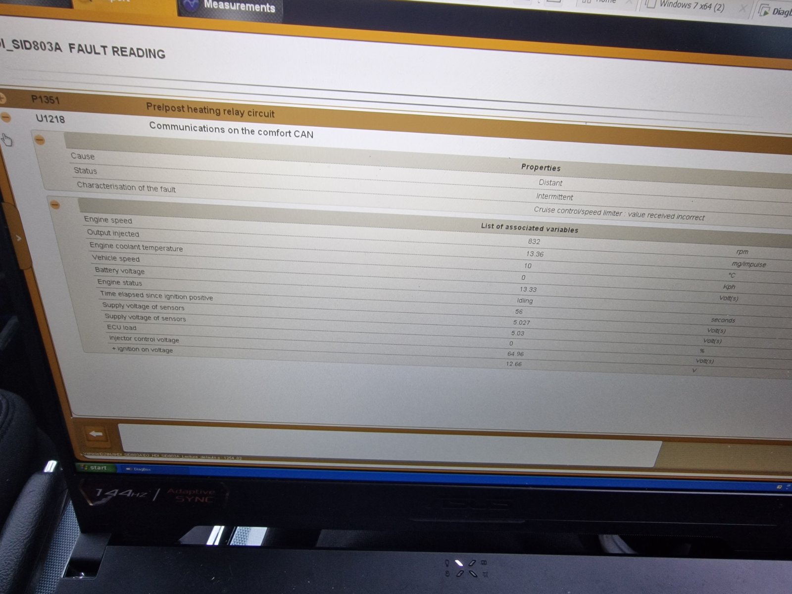

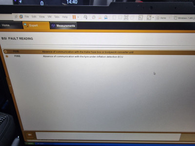

Done the actuator test on ac pump, and the car clicks! (Through diagbox).
No errors in BSI / ECU itself, just the below 2.
As there is no separate AC ECU? But I still went into the block and there are no faults detected?
