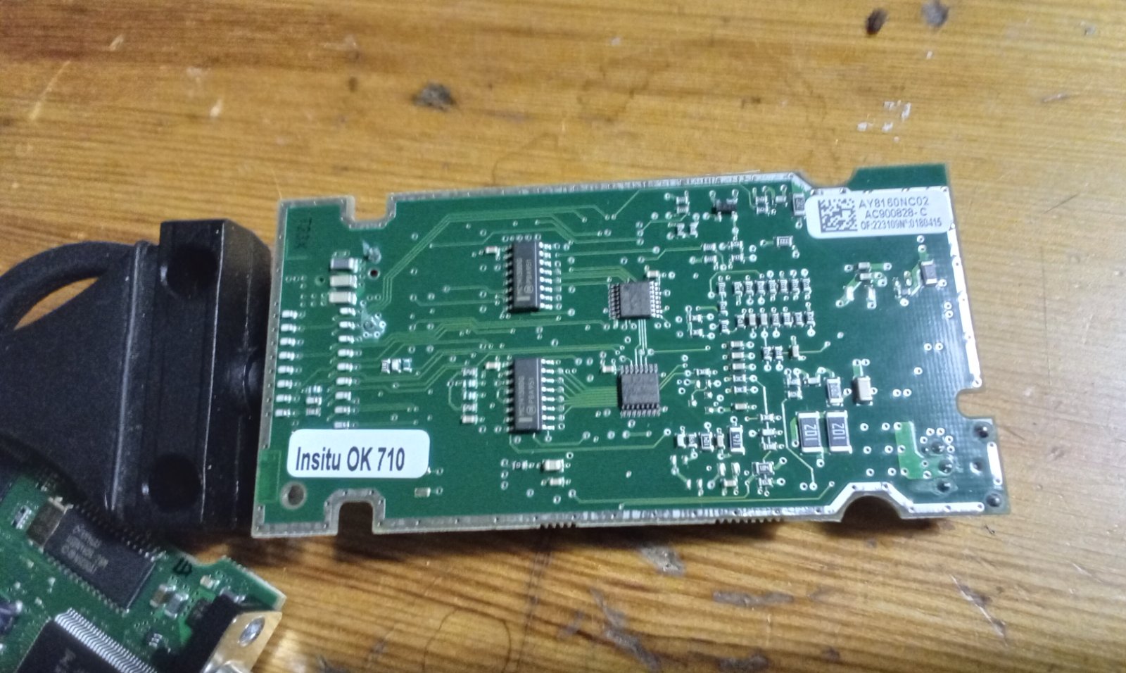

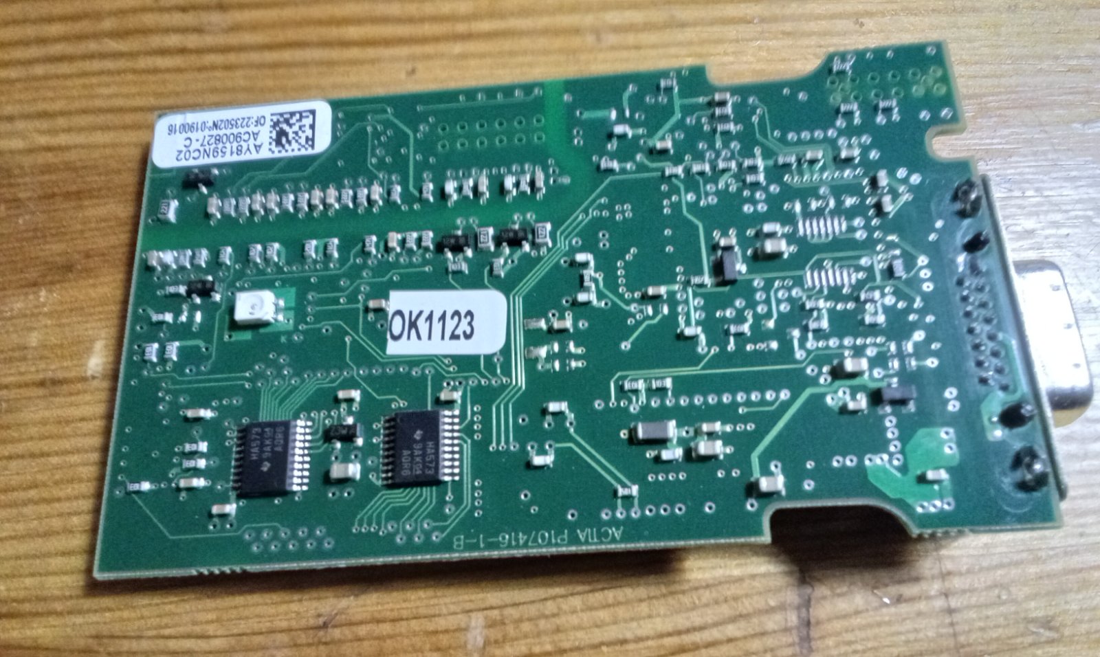

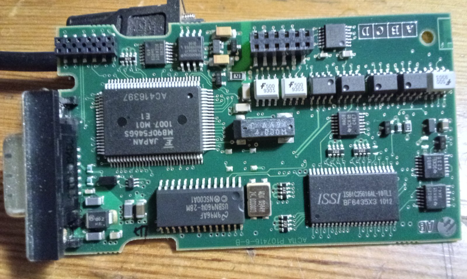

HI
The attachment 20241027_161914.jpg is no longer available

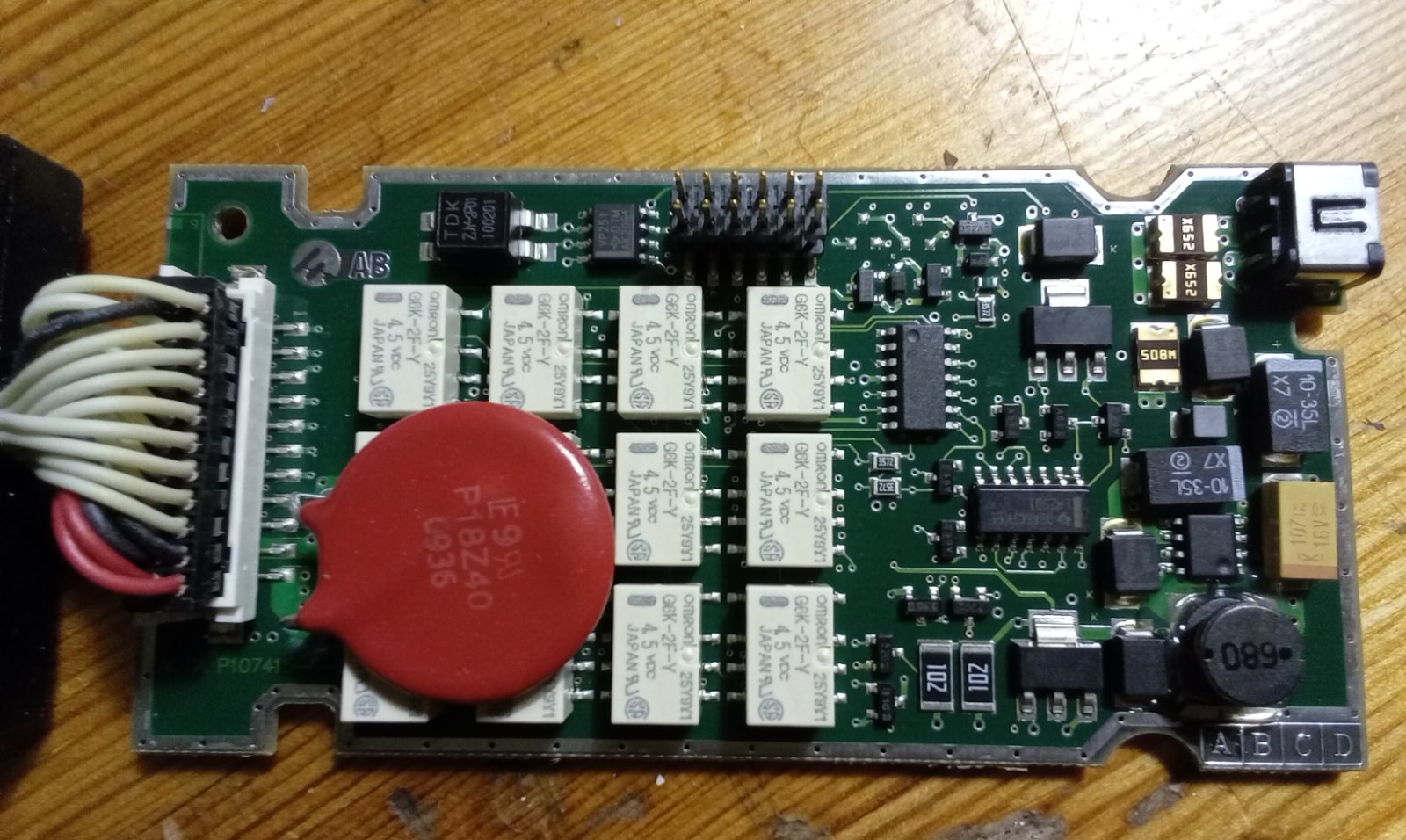

everyone is asking the question because mine has a big red capacitor
While most of the ones shown on the internet have a blue capacitor plus I haven't been able to conduct a global test with different versions of Diagbox here are some pictures and hope you help me sort it out
The attachment 20241027_164449.jpg is no longer available

It's a full chip interface. The color of the varistor doesn't matter, it's the same. The varistor serves to prevent electric shocks . Is the interface checker working?
What year is your car?
