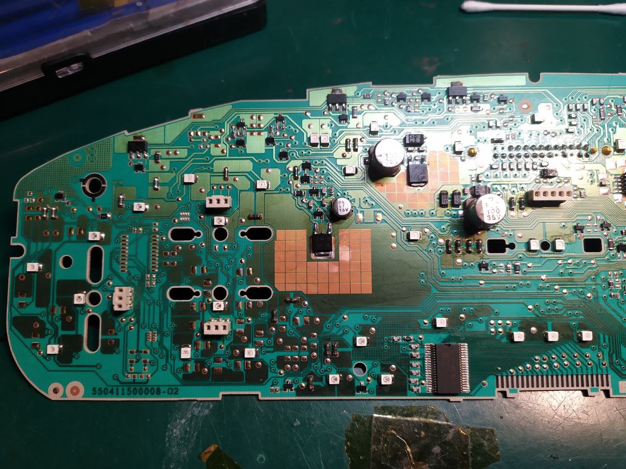

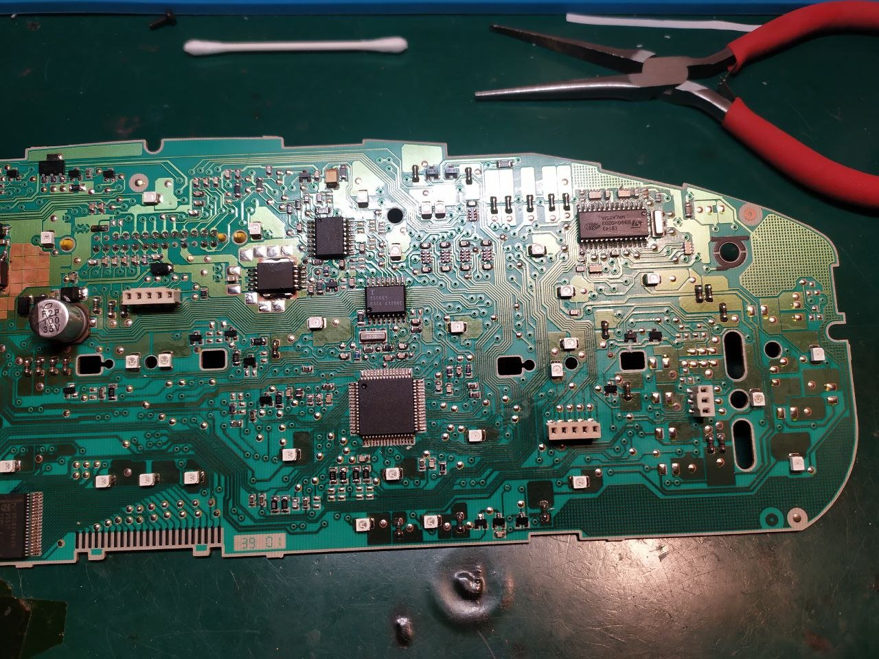

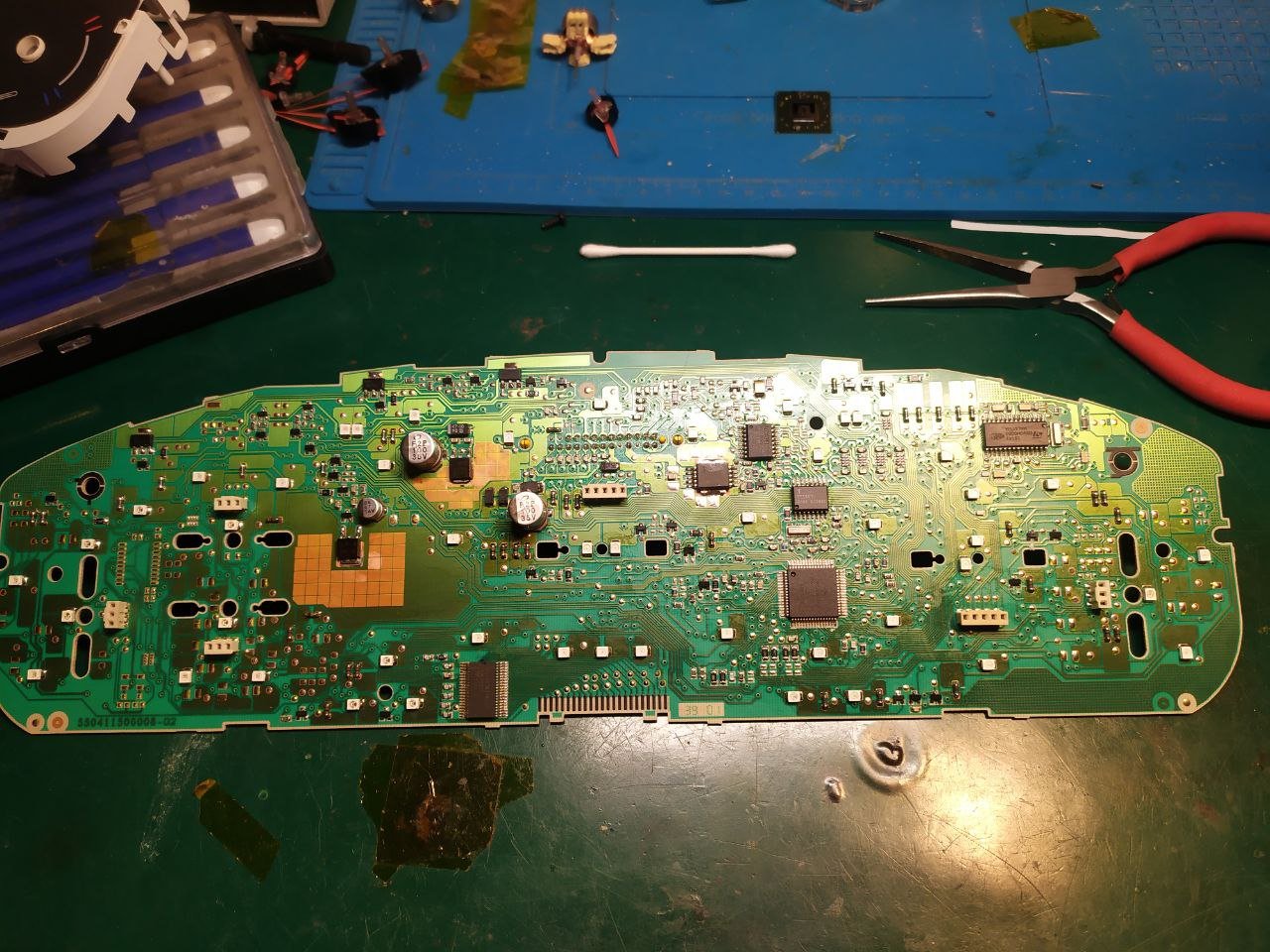

I would like to say hello to everyone and describe my problem. On the speedometer the green LEDs are flashing, it doesn't matter if the car is driving or stationary. I only have the petrol level, temperature and battery charge permanently illuminated. The rest can flash like disco or not illuminate. I have checked all diodes - ok, resistors - ok, soldered with lead tin all components - no change. Below is a video of the flashing and pictures of the meter. Thank you in advance for your help.

It sounds like some of the PCB-mounted background illumination LEDs are intermittent. You could check the continuity of all the solder tracks leading to the LEDs, especially any common earth. Other than that, I suggest you have an intermittent fault in one of the integrated circuits on the PCB. Unlikely you will find it, nor fix it.
