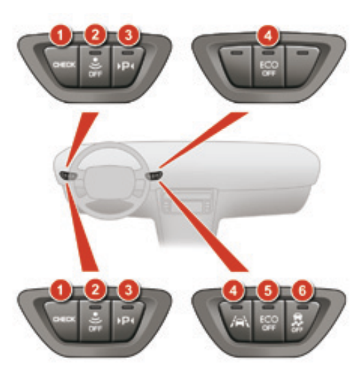

I wanted to do the same. I have those three blanking plugs where there's room for three buttons. I thought there's probably a loom in there anyway. However, I removed the buttons behind the right-hand stalk and there was no connector, no loom, no nothing.
I know sometimes cars are made with the same looms so as to cut costs, so my question is: is there a loom or a connection that I can attach a cable to?

No. Original wiring looms are NOT the same and are fitted according to options at factory. You should also be careful NOT to splice into any CAN wiring or expect issues with electrical systems.

No, I'm just saying be careful what you do Looking at this mod, I don't know where he has got this switch module from but there are 12 types of switch that go here, depending on build date and equipment, and none of them have these options as you can see from the latest X7 manual with touchscreen. I suspect this is from some Chinese supplier and he has no instructions or links, so I'd take it with a pinch of salt.
