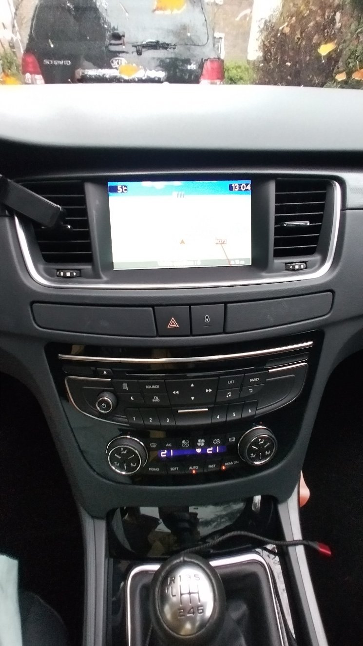

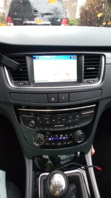

I've become the proud owner of a 2013 Peugeot 508 SW as of last week. Love the car so far, but noticed that the navigation was still using 2014/2015 maps. I've been reading and searching through the forum to figure out exactly what kind of system I have and truthfully I'm only becoming more confused. My center console looks like this:

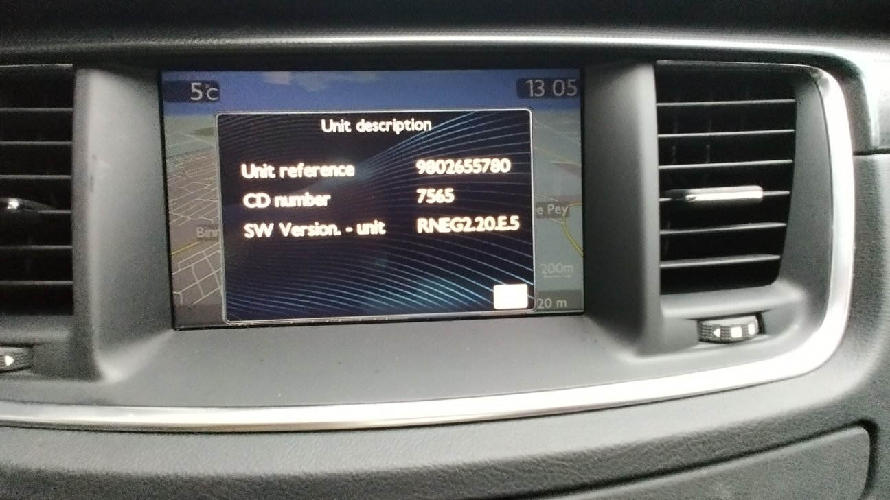

The unit description gives the following as a version:
RNEG2.20.E5
Going to peugeot.navigation.com and inputting my VIN tells me I have a WIP Nav+ RT6
It is my understanding that the RNEG2 and RT6 are two different systems?

You have RT6 but the unit is also referred to as Wipnav+ for Peugeot. The reason you may have had difficulty identifying the unit is because on some vehicles the controls are integrated into the fascia as opposed to being on the head unit itself.
Yes, you can get maps from Peugeot navigation, but you don’t need to update the firmware necessarily. In fact, you can actually have problems when you update the firmware to the latest version which can leave the unit in operable.
So for now, I would just focus on updating the navigation maps and leave the firmware alone if all works well.
