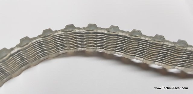

Peugeot had a wet belt engine in the early 60’s
My 404 in my Avatar had Kugelfischer Injection, the pump was driven by a small sedis belt inside the timing cover with the timing chain. It was made of a sort of plastic with wires running through it, never needed replacing.
