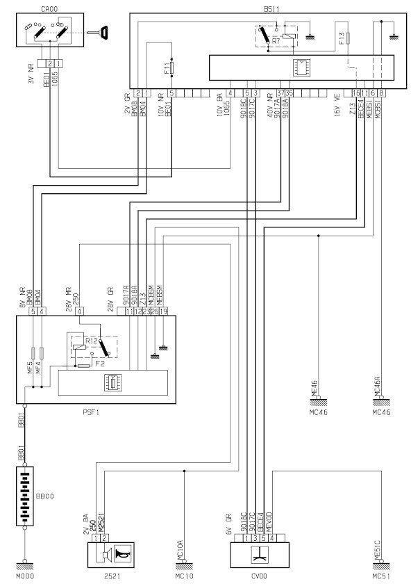

Hi need wiring diagram for Citroen berlingo 2010 horn fault
Vin No VF7**************[VIN obfuscated, can be read by forum staff]
I have fixed horn faults before but seem to have lost wiring diagram
I know it involves coms 2000 ,bsm, under bonnet fuse box
Thanks Joe

Here you go, pretty simple circuit.

Thanks wheeler for diagram, horn circuit
Simple circuit when you have diagram
Thanks Joe
