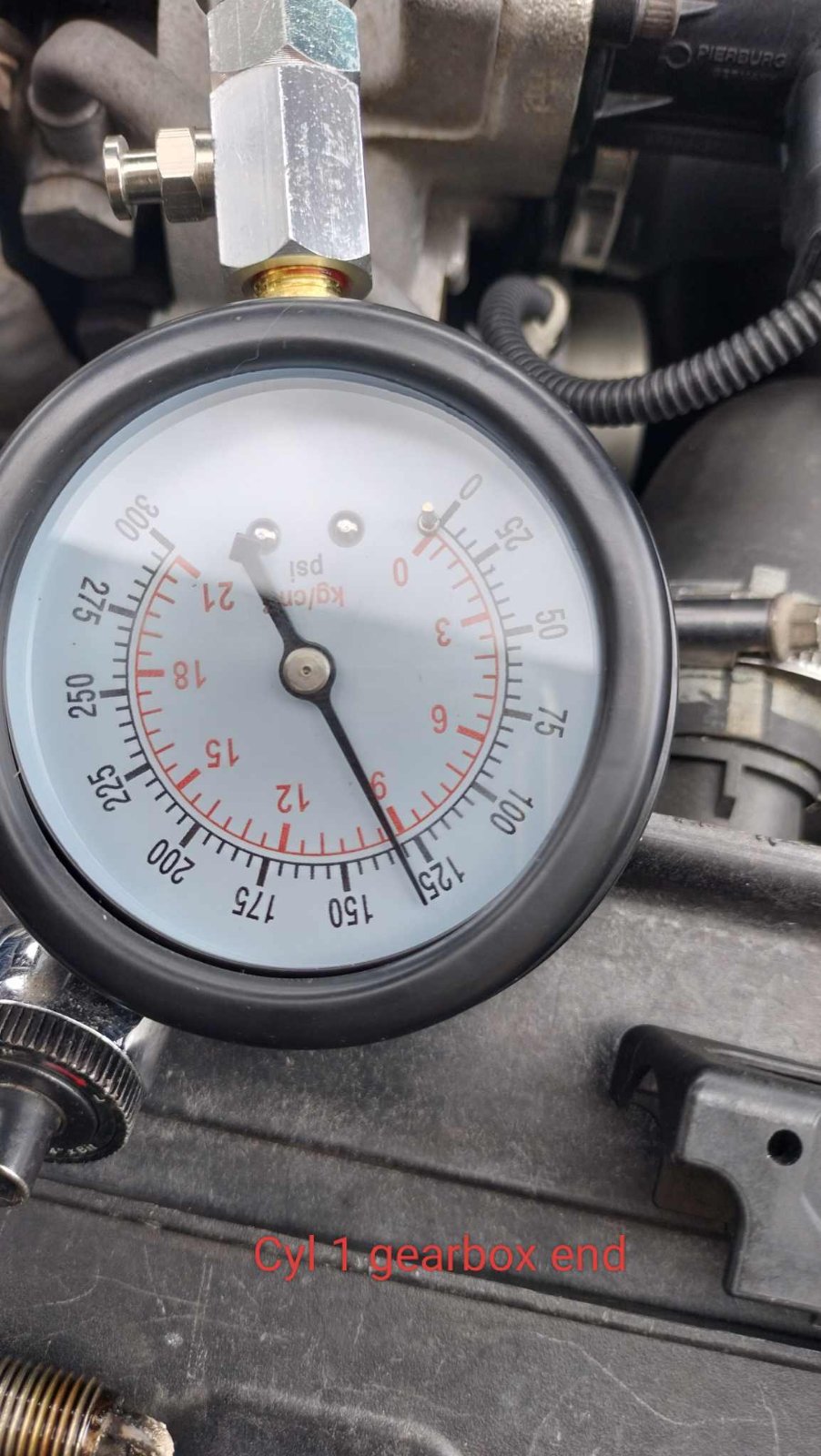

Well, Christmas and new year is over and I finally have an update.
The engine cover and air intake pipe have been replaced, and compression tests have been performed.
Unfortunately the results are not what I wanted!
From Gearbox end:
1 - 134
2 - 143
3 - 140
4 - 60 - bugger!

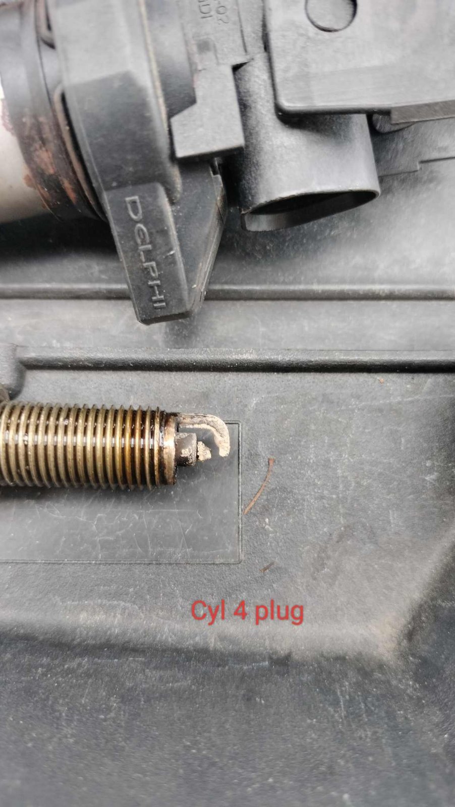

Also the plugs were fouled (burnt oil deposits? - I didn't take a photo of plug 1 as I had already screwed it back in and couldn't be arsed taking it out again, as I am doing the work in the open, weather here has been either too hot or wet to do work on car.)
Oil consumption was 900ml for 572 km.
I think I need to take it to my mechanic - (clutching at straws - maybe a valve clean??)
From Gearbox end:
1 - 134
2 - 143
3 - 140
4 - 60 - bugger!

Not looking good. I have no good answers but a carbon clean of the valves will not reduce oil consumption. If the 60 psi compression pressure is real, then I suspect a problem with the rings (gummed up?) is causing severe blowby which then carries lots of oil vapour back into the engine via the PCV system.

Cylinder 4 could have valve/seat damage or head gasket. Possibly the valve guides are worn and their seals need replacing. When you accelerate, then lift off the accelerator and then accelerate again do you get smoke from the exhaust which could be a sign of valve guide wear ? Also on first start getting smoke can be a sign.
If there is a smoke when just accelerating then that might be a sign of turbo wear - I had this on a Saab before the turbo failed.
When doing the compression test if a bit of oil is put in the cylinder does this increase the pressure - if so it is a sign of worn piston rings or damage to the bore.
I suspect the cylinder head needs removing and reconditioning.
