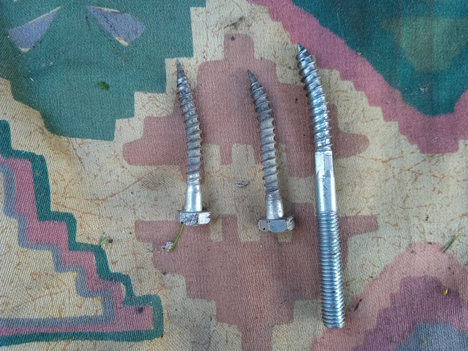

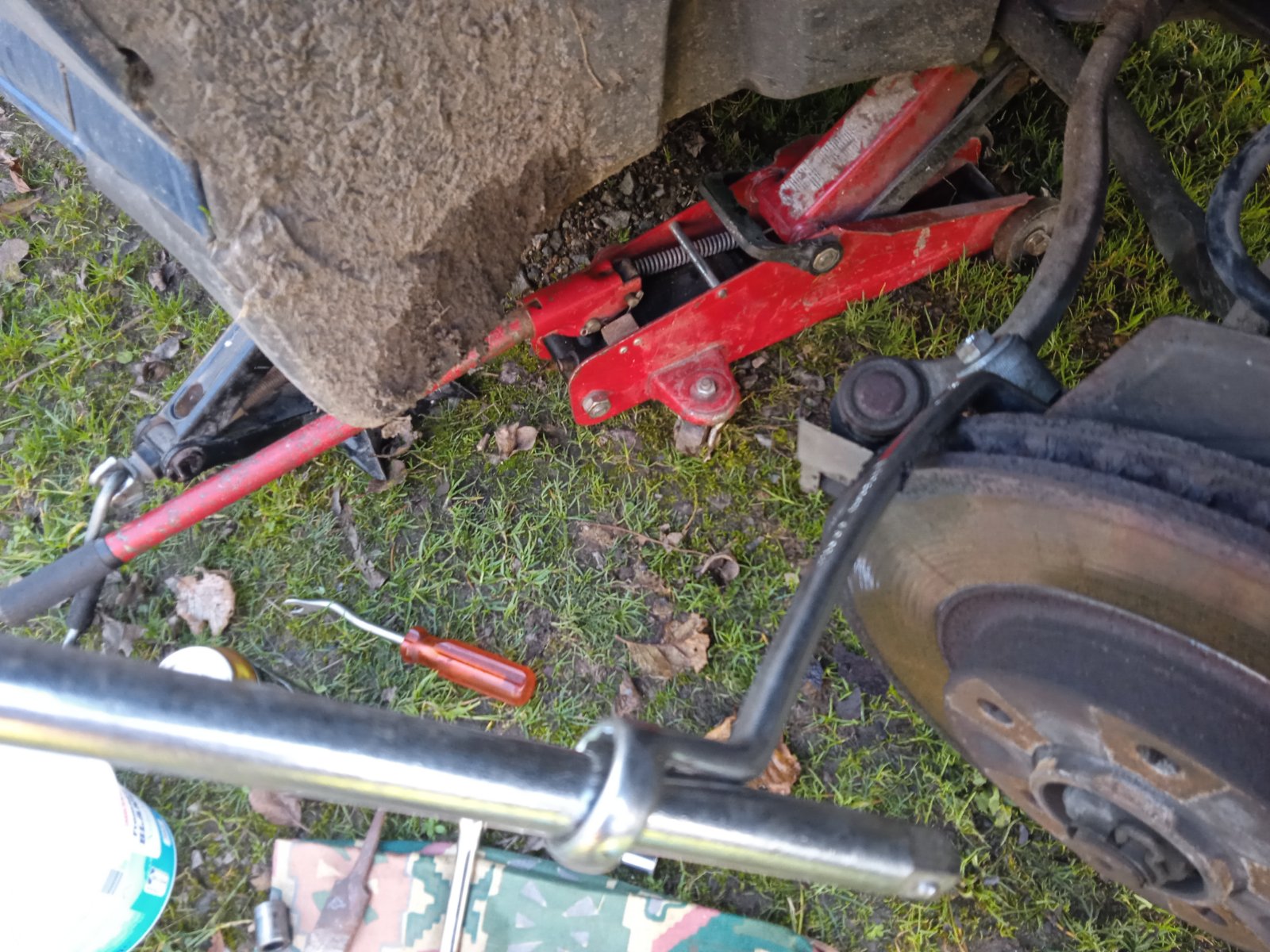

Update....not a chance in hell
Bent the coach bolts trying to lever it out.
Look at the bend on that.
I'll drill the sod out tomorrow. I'm not worried about the bearing or hub, more the debris taking out the new sensor.
