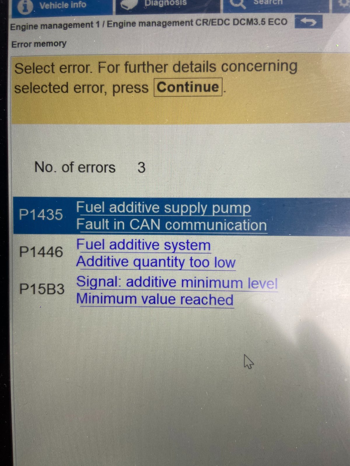

Hi,
I have a DS5 2.0 ltr HDi. Fault codes are P1446 fuel additive system additive quantity too low and P15B3 Signal: additive minimum level minimum value reached. I have fitted a new OEM tank with pump and filled it up with additive fluid but it wont let me reset the values or or tell the system that i have replaced the tank. I have tried the Bosch KTS, Autel and Hella diagnostic machines. Can anyone help please?

Re: Fuel additive system
We have the Bosch KTS and tried going into both the control units that you mention with no success. The live data does not seem to be reading the tank level, just shows 1.2 ltr with or without the plug connected. Struggling to find a wiring diagram, non on Autodata.
All sorted. Didn’t realise the key must be in the key holder before it will let the diag communicate with the car. Put the key on the holder, cleared all the faults and initialised the additive pump and hey presto good as new. Thanks for everyone’s help
