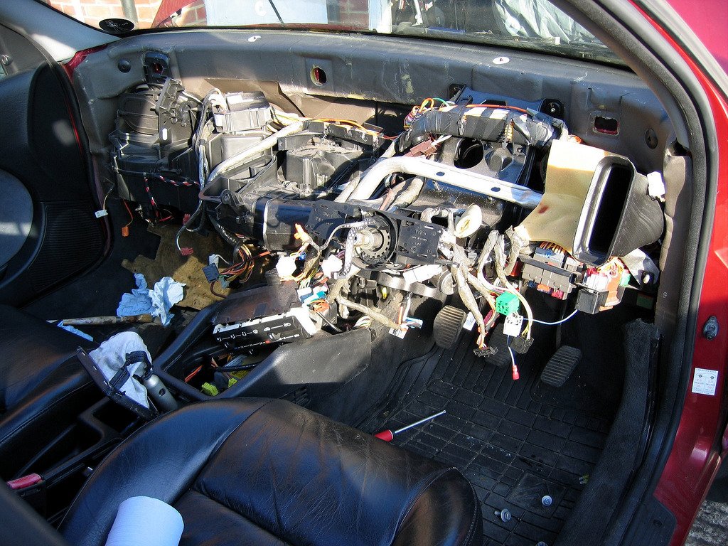

Ah yes, but you were right, and now it's get the whole (@?*^! out, which thanks to your input, is much simpler than it needs to be. (or not, as the case may be!)

Welcome to Activa ownership! I've had three in the past and done maybe 10 or 12 heater matrixes in them over the years so I feel your pain...
Any cooling system additive to attempt to stop matrix leaks can cause big problems, they can clog the oil cooler and worse, they can 'weld' the matrix bulkhead connector together and make it very difficult to separate. This part of the job needs huge care at the best of times to avoid damage to the connector.
As Alasdair says, only use Forte Stop Leak...
Good luck and any problems, you know where we are

I've got the Haynes manual, but I'm a little concerned with it- I didn't need to take the steering wheel off (and the airbag!) to reinstate the instrument panel, and so I wonder how much else I won't need to do on a Series 2.
Jim, 10 or 12? On 3 Activas? What???? Does Phil G know about this !!!
I'm about to use Forte, until Spring, the garage isn't big enough for me to get inside it, and it's full of the DS anyway. Then I shall breathe deeply, and get on with it. Hopefully, I'll get both of the Tractions working by then....
