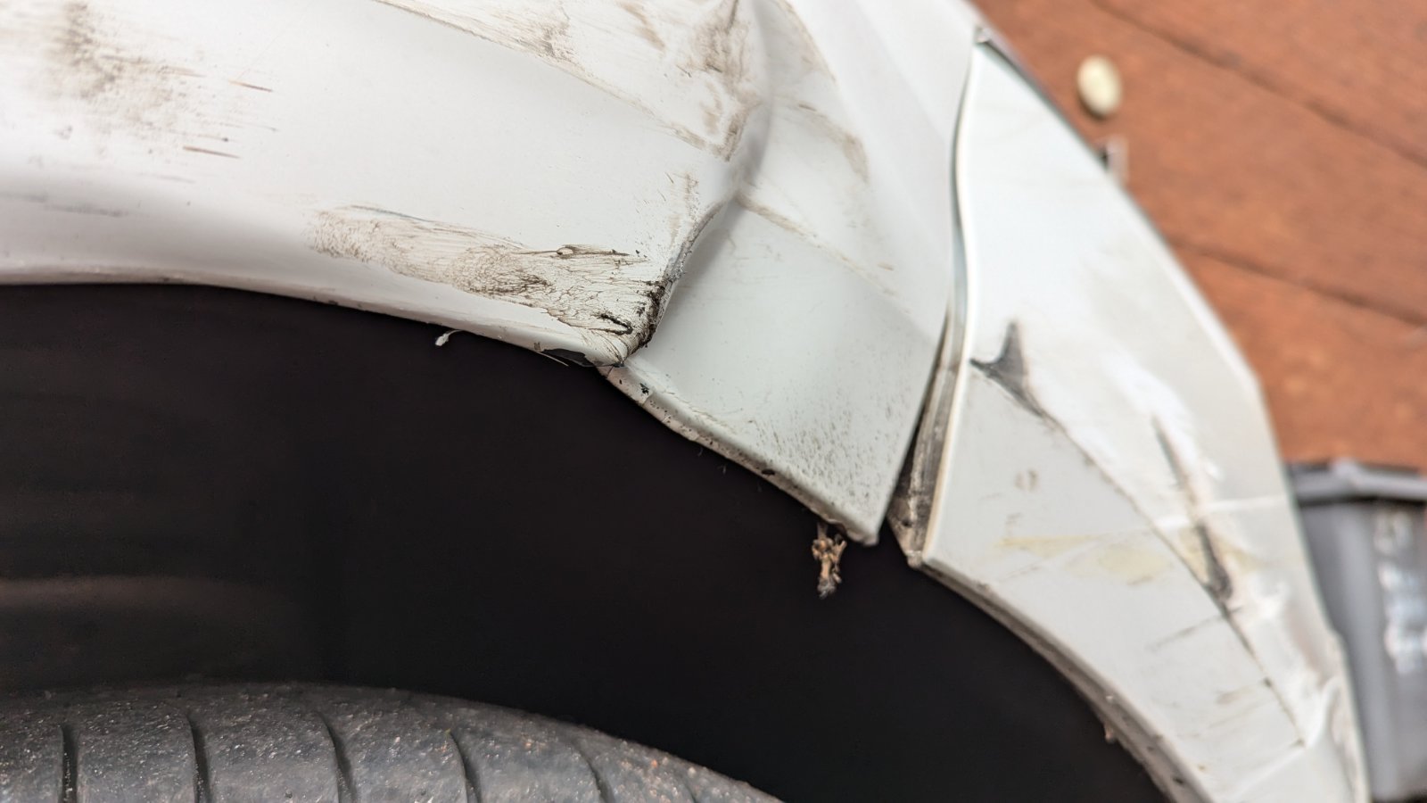

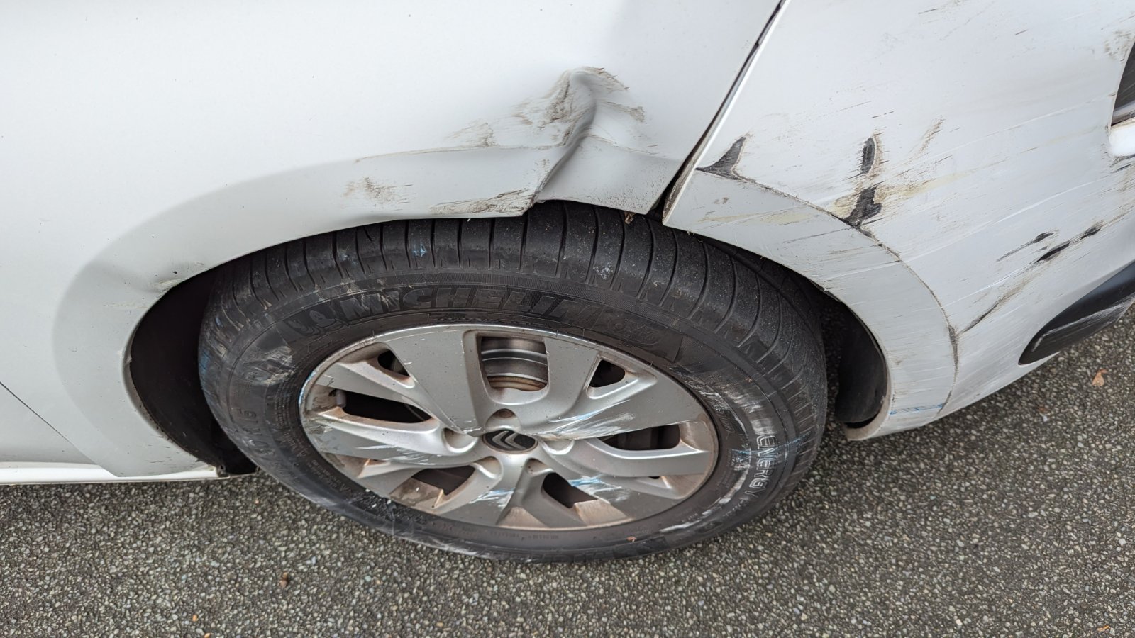

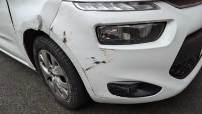

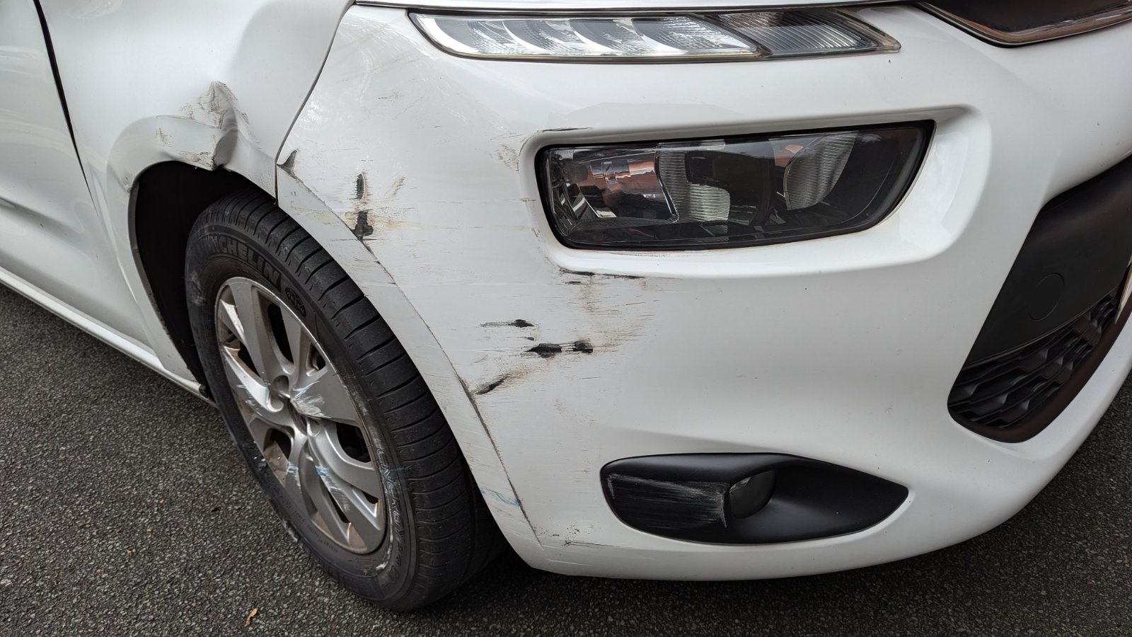

Insurance have offered me £4,244 or £3,055 if I keep the salvage. The repairers quoted 7k for parts and labour.
Obviously they'd use all brand new parts for that. I was wondering if the repair could be done for a fair bit cheaper and the car kept? Has anyone done similar repairs? To start with I have a spade full sized wheel so that would replace the damaged wheel.

You will be able to find a wing/bumper etc in the correct colour (I would think white is a common one) via the breakers network in the UK.....bolt on..... I would think a few 100 pounds would do that.
I cannot see the insurance will load it due to CAT-N....they will because you have had a prang however.

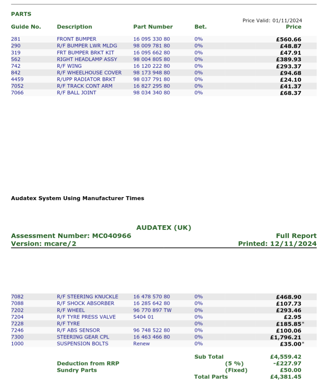

Looking at the list of new parts costing about £4300 then the damage would appear to be more than just a bumper/wing replacement and includes a light and the steering and suspension so the chassis might also need to be aligned professionally. Have you looked at the cost of a similar replacement car in good condition, this should be the amount the insurer is offering you but if not then get back to them for a higher offer. I would also get a good idea of the cost of parts from your possible sources to see what it may cost for a diy repair. If you end up spending a lot then you would be better letting the car go but from the insurer offers you have to spend a lot less than the cost of new parts (as in the quote) to get it back to original condition and value to even be worth your efforts.
If you do keep the car and repair it to get it insured again you will need the car to be professionally checked so the insurer will cover it again - I had to do this with a car in the 1980s and this was a new MOT, otherwise it would only be valued as scrap. They also asked for receipts from the repairer but I had to explain it was a diy using s/h parts. If you ever try to sell the car again you may not get a good price and you may have to declare it was written off.

If it was just cosmetic I'd do it, but with suspension parts and rack it's going to add up. Think you posted this on FB and it has done >> 100K? in which case I would let it go probably. Are you claiming off your insurance or third party's?

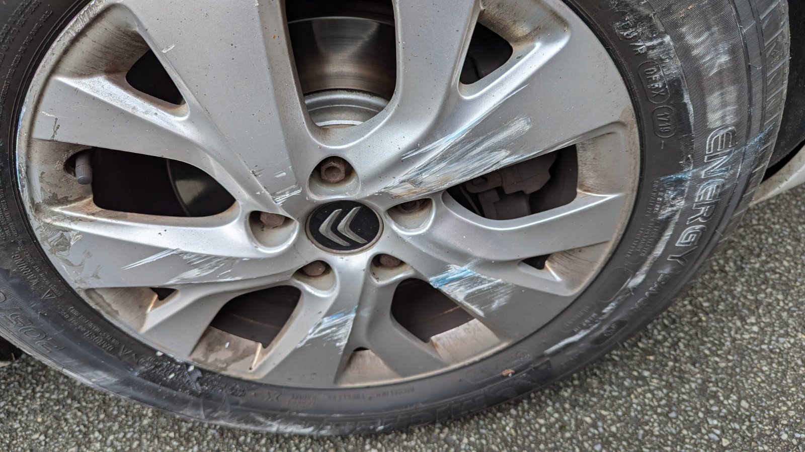

The list of parts required is a "worst case" estimate, the actual damage is probably much less. The wheel is still located correctly in the wheel arch, so I would think on probability there is no suspension damage, or maybe a lower arm. The track rod or hub may have got bent, but unlikely the rack. The fact that the wheel has slid past the obstacle without the rim being broken or tyre ripped would indicate that there was not a huge impact through the suspension and steering.
I would repair it without hesitation if it were mine.

Well there is a £300 +vat wheel there which is a £120 (max) referb .... it is hard to see that breaking the steering rack ....but it all very much depends on the OP skills/facilities etc.
