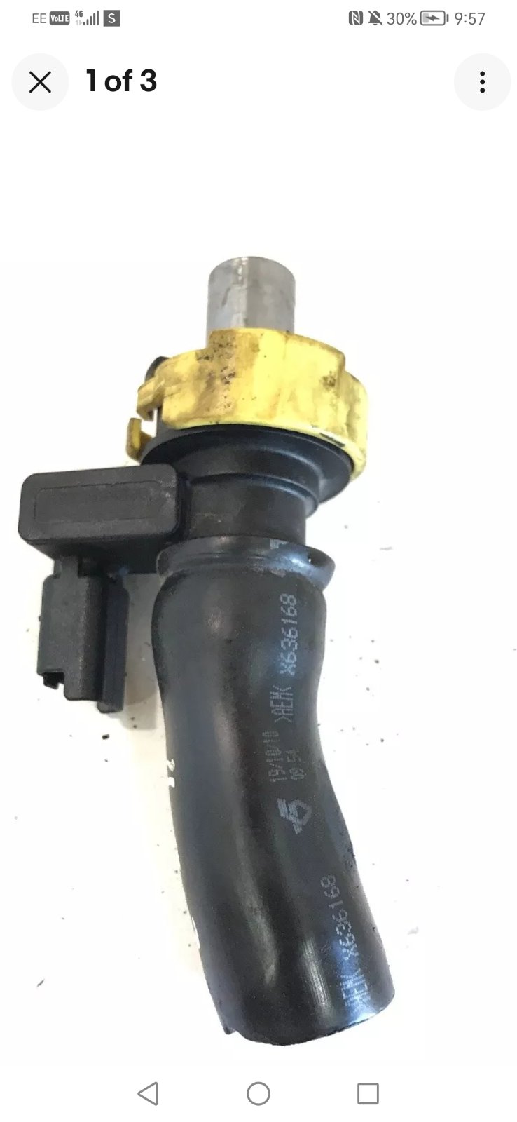

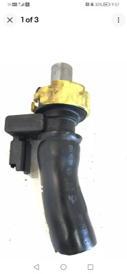

Been on live data ambient temp showing 7 intake air sensor showing 15 disconnected maf sensor intake stays same temp highest intake temp gets to is 25 with a fully warm engine there is another sensor jyst before turbo with yellow clamp on could this be intake air temp sensor? Thankyou
991hughes
Posts: 22
Joined: 08 Nov 2024, 21:17
Re: Air intake sensor
Unread post by 991hughes »
Same as this
