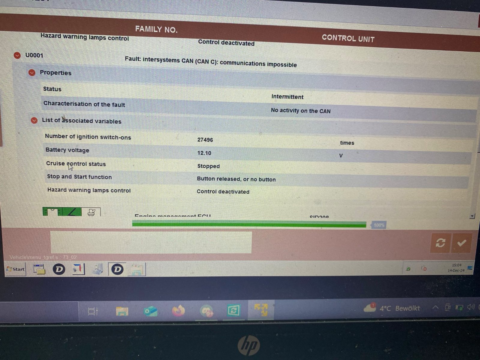

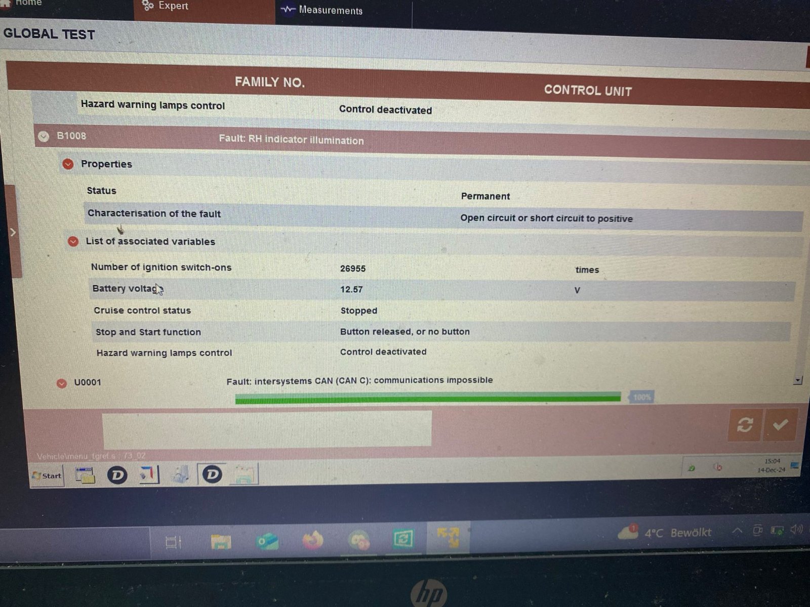

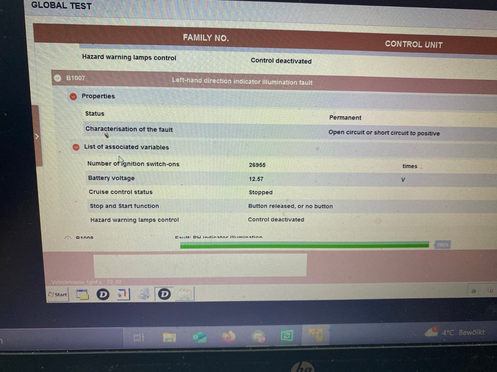

Allright thank you very much! i was able to resolve the issue, it seemed like the can connection from the bcm to the port was bad, i was able to fix it. Now my BCM is throwing the following errors
B1007 - left hand indicator illumination fault
B1008 - right hand indicator illumination fault
U0001 CAN C - Communication Impossible
I attached images for that. I tried changing the lightbulbs for the opencircuit faults, but this didnt fix the issue (the direction lights are actually working)
One thing ive noticed while changing the lightbulbs: when removing the headlight on the passenger side (rightside because its a german car), a disconnected electric connection gets visible. But sadly only the bare adapter is present, the matching counterpart is nowhere to be seen. That might very well be the solution, but i have no clue where the adapter is meant to be connected. Maybe im just lacking some feature in the car but the connector is there anyways?
Anyways id be very intrested what this could be.
Can you provide any advise how id start to fix theese problems?
Especially im intrested for more information about the CAN C Network if that woud be possible.
Thank you so much for you help so far!
Kind regards
Leon

I've just had a look for these codes and nothing is coming back (which is possible with these commercial vehicles as this one is a Ford variant).
But the CAN is not communicating in certain areas. Here is the signalling diagram that may help:
