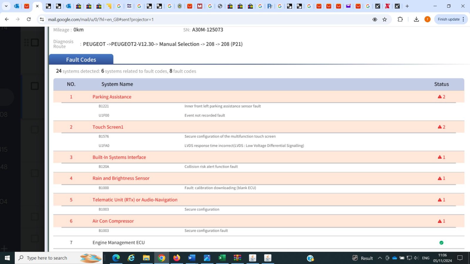

Hi
I am looking for help to fic the DTC for a Peugeot 208 MK2.

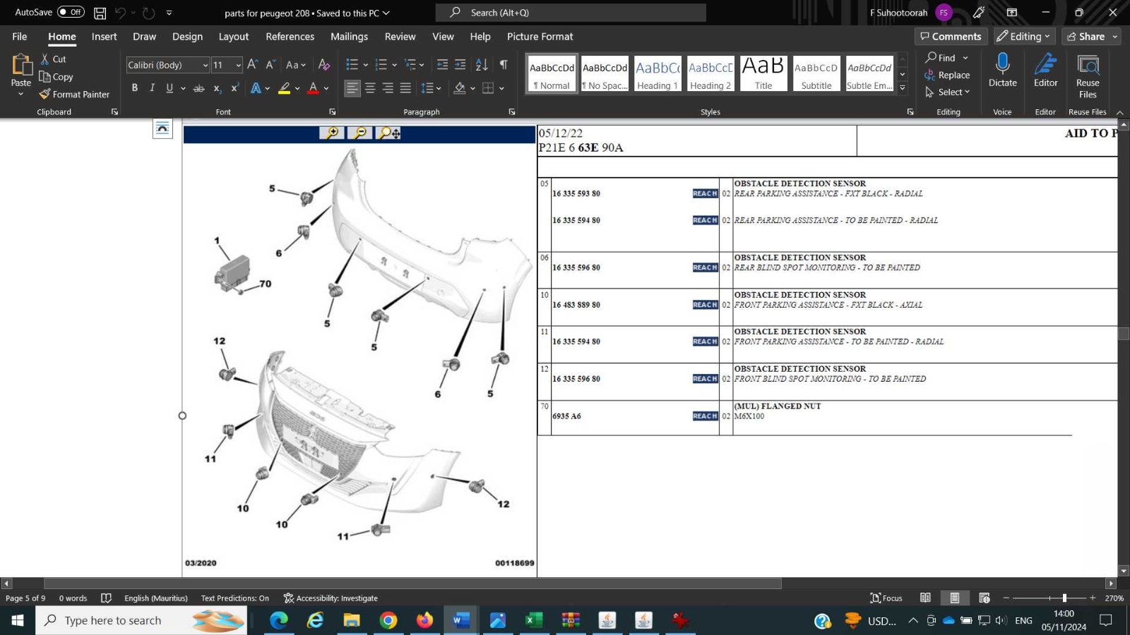

Also which sensor could be the potential fault for parking assistance 10 or 11?

Unread post by Fuzz »
I changed the front inner sensor and everything worked fine. A lot of cars use the same sensor made by valeo
