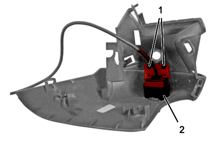

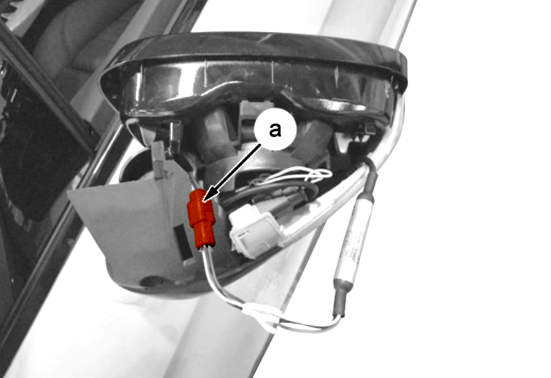

Re: Wing Mirror DS5
I can't help you in that case as this sounds like the last model before discontinuation, and these had blind spot cameras:
Connector shown at 'a' and camera at (2)
