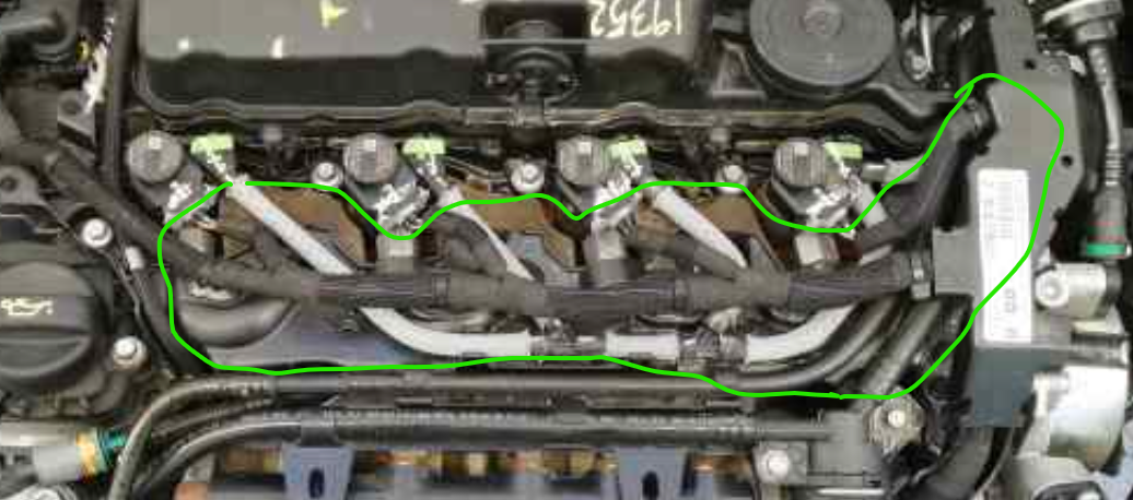

Have managed to get the old ones out, but had to do a slight workaround as can't figure out how to completely remove the plastic cover that sits between the other pipes and the injector hardware below. Undid most of the bolts for it, enough to get at to remove them. They were all fairly mucky and all came out with the copper seals apart from cyl 1.
Now the problem will now be cleaning the ports to get the new ones in (due to the poor access) - I have bought the cleaning tools to do the job from Amazon - but is there a trick to getting the cover off on the right hand side of the engine near the air intake?

Its the cover in this area circled

Managed to do it without removing that cover - however put it all back together and then noticed one of the new copper seals on the floor!
Worked out which one it was by laying a flat straight piece of metal across the top of the injectors to see which was sitting lower by approx 2mm (it's number 1, nearest the gearbox).
Will have to get in there again and fit the washer - will probably have to order a new bolt for that cylinder as they are torque to yield, but will probably be ok for a short while.
