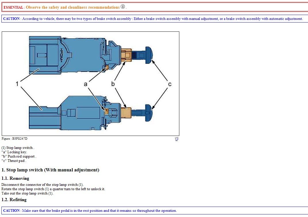

Re: C6 NEW BRAKE LIGHT SWITCH 4534 66 is TOO LONG
Do you have a pic of the switch? Most are adjustable, some are adjusted with fitting & some the switch itself adjusts.
wheeler
- Posts: 7937
- Joined: 21 Sep 2002, 19:07
- x 1060

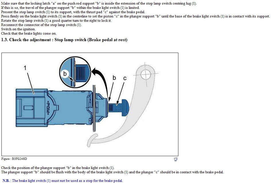

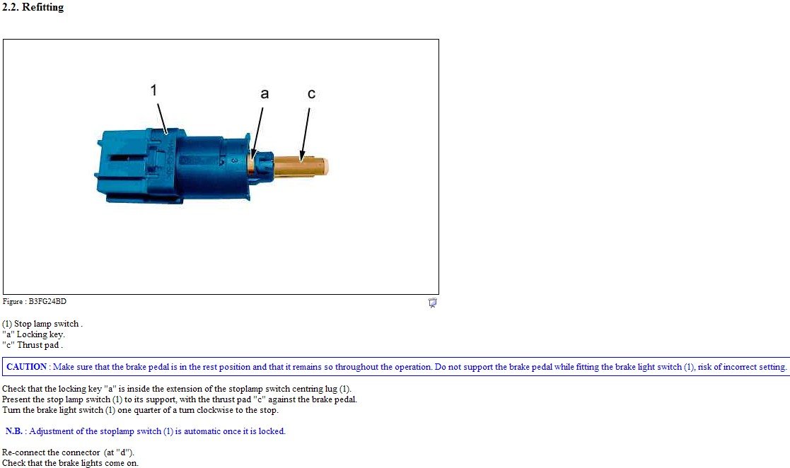

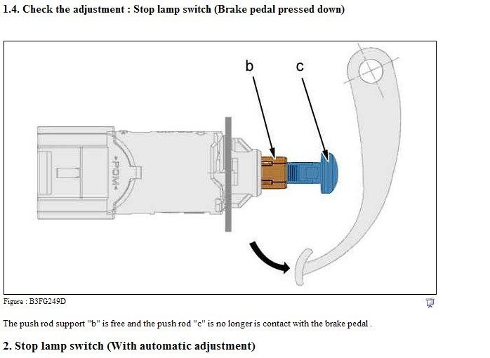

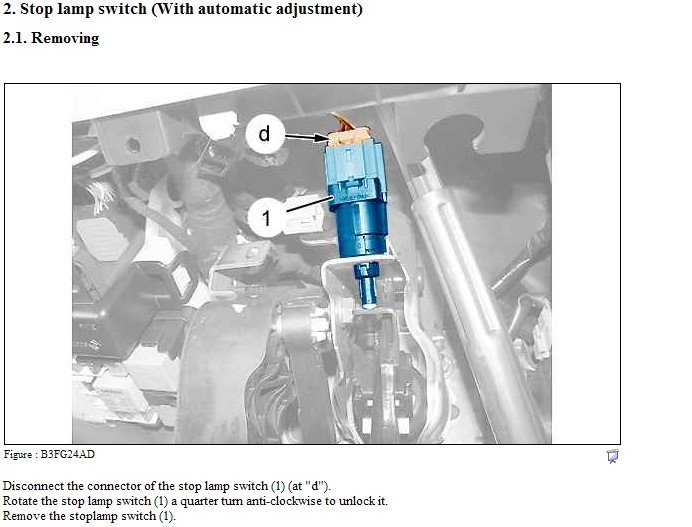

These brake switches have to be one of the most incorrectly fitted car parts i have seen, You must follow the instructions below for fitting the new switch.
Most people just push it in & twist it, This will lead to incorrect operation.
