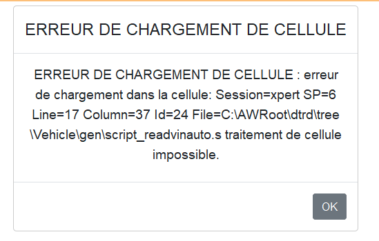

Today I bought a Lexia 3 Wifi diagnostic device and was going to activate the cornering light feature of my Peugeot 3008 2017 model vehicle via Diagbox 9.150 software (via BSI). However, there are 2 options in the Configuration section. One is viewing and the other is editing. When I try to enter editing, I get the following error:
When I click on the first option, I can only view the settings but I cannot change them. I should be able to do this from the 2nd option, but when I click on the 2nd option, I get the error above. They said in the forum that it works when they turn off the internet and try, but when I turn off the internet and try, I get the "No Internet Connection" error. What should I do, how can I edit?
I am watching videos on Youtube, a friend of mine is using version 9.146 and activates the cruise control feature. That friend also directly selects Manual Configuration instead of 2 options and can edit it as he wants when he clicks on it. How can I do it?

You cannot configure ECUs with Diagbox V9 in manual mode. You have to be online with an online Servicebox account and purchase tokens from PSA. The ECUs are locked.

Hi, where can I buy it and will it work with my lexia 3 device?GiveMeABreak wrote: 31 Oct 2024, 22:20 Hi

1) I can't advise you on whether your VCI hardware is compatible as you will likely have a clone and if these are not Full-Chip versions they may not work.
2) You may need to download the original Diagbox Software once you have created an account.
3) You need to create an account with Citroen in your country:
https://www.technicalinformation.fiat.c ... ab26967be4
