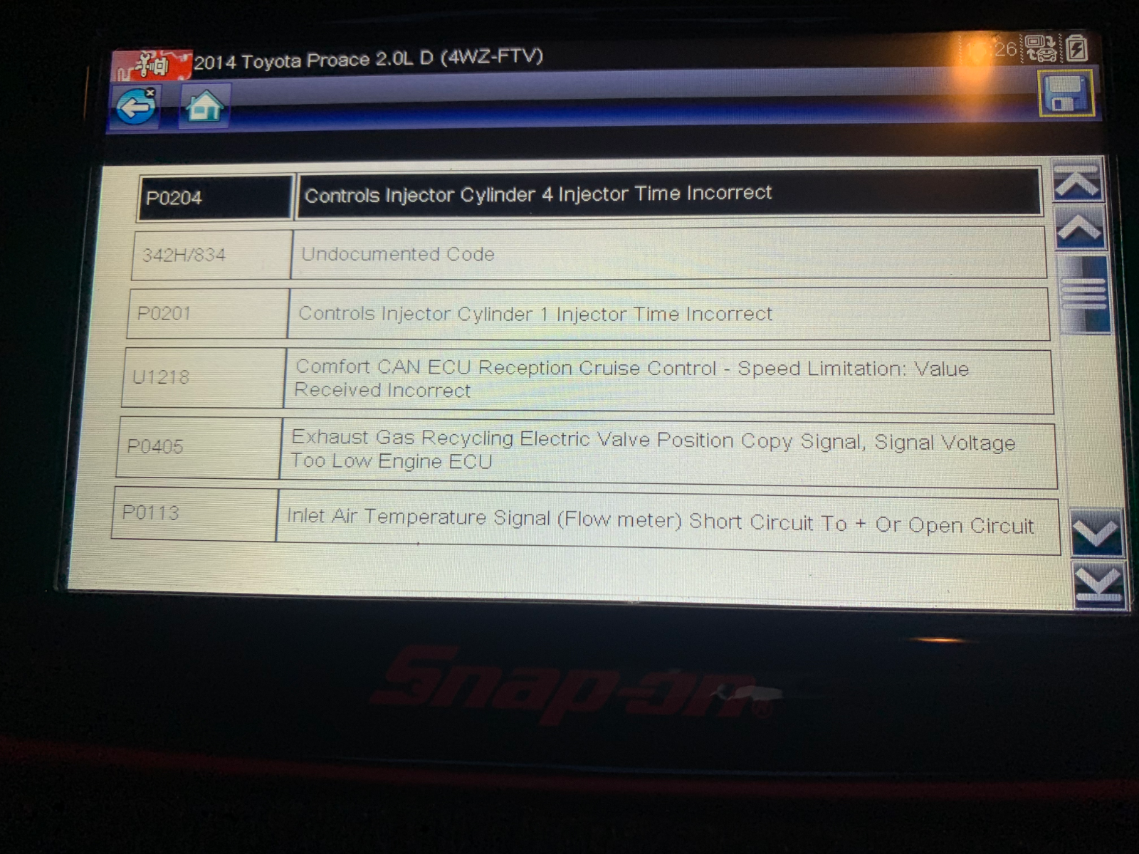

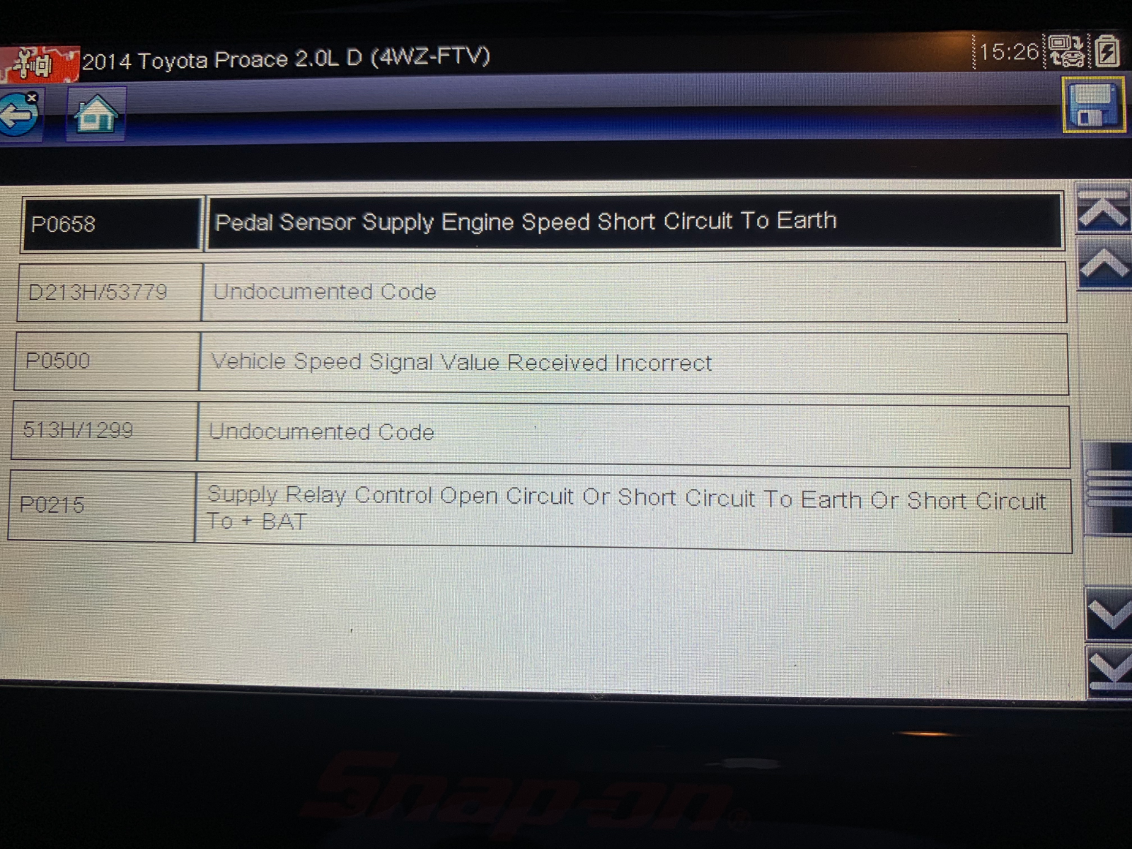

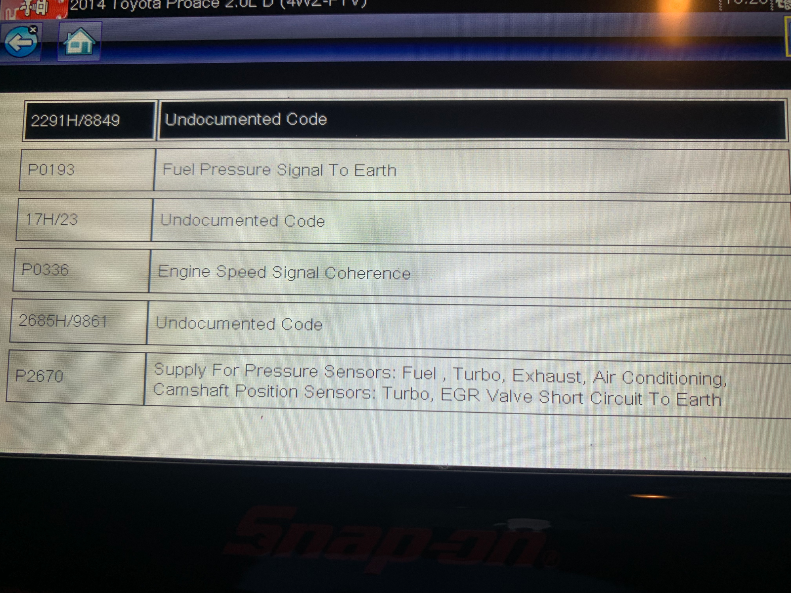

I recently purchased a 2014 Toyota pro ace / same as a Citroen dispatch Peugeot Partner. 130,000k
Previous owner said it stalled and stopped then wouldn't start again, cranks over fine but won't fire at all.
I have attached the images of the diagnostics, seems to have a lot of faults to ground including ECU
Has been looked at by garages with no luck. Crank sensor has been replaced, there's fuel getting to the injectors
Any help appreciated
thanks

what checks have been done? Has the timing belt/valve timing been checked?
On live data do you have engine speed?
Cam & crank syncronisation?
Whats the fuel pressure on crank?
Does the engine fire with a squirt of easy start?

I don't have any live data available as I don't have a code reade.r all I have is codes posted plus the fact that it will fire on easy start, thanks
