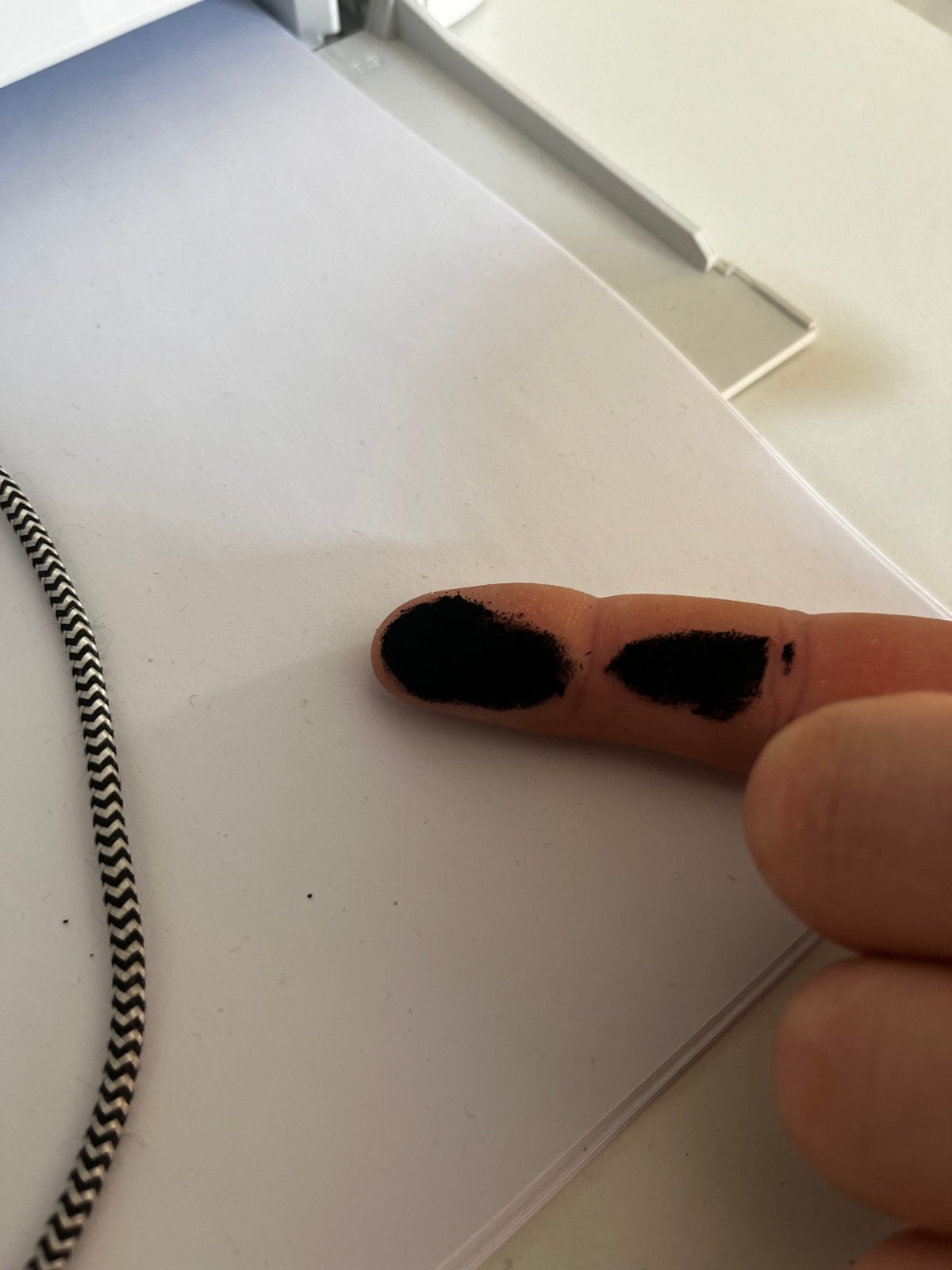

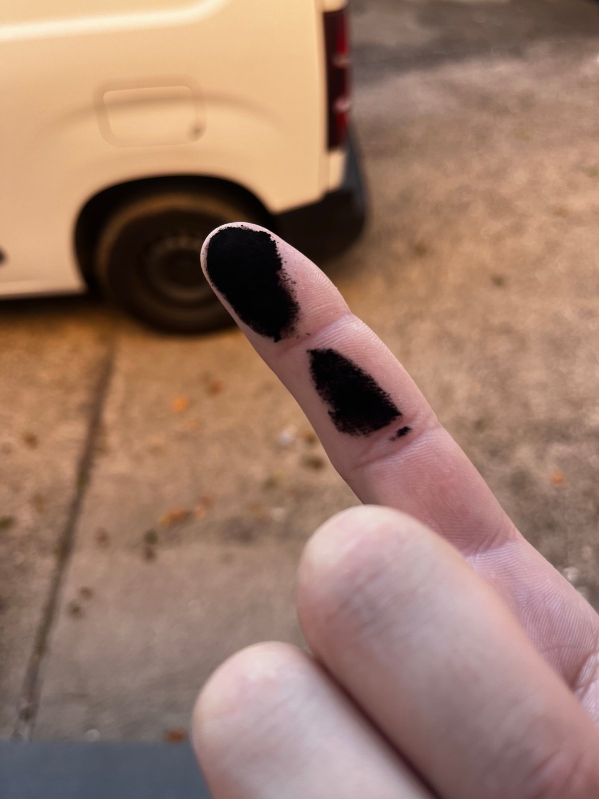

The DPF is definitely there—I’m attaching a photo of the black residue I found. It seems like something may not be working properly, but I’m unsure how to confirm or fix it. Any advice on what steps I should take?
Thanks in advance!
Thanks in advance!

I think you're misunderstanding what we're saying:
The physical catalyst / DPF outer housing may be there, but that doesn't mean the particle filter hasn't been removed internally.....
If you provide your VIN I'll be able to see which engine this is. Please post your VIN in full without spaces - it will be automatically masked from public view after submitting your post & will only be visible to staff.

It needs a replacement DPF, but it may be that a previous owner has had it mapped out, in which case it will be difficult to re-instate it.
