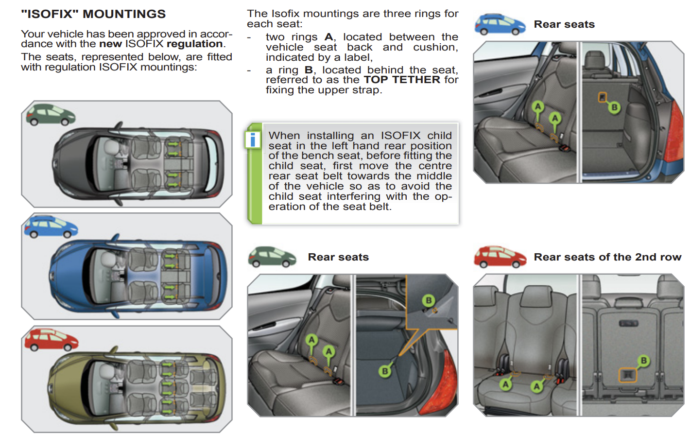

Hello,
Having taken the plunge and got a new dog I'm trying to fit a "universal" harness to the rear seat of my 2010 Peugeot 308. The harness states that it is designed to use the "Latch/Isofix/CanFix three-point anchor system".
I've found the two ISOFIX points at the bottom of the rear seat but am at a complete loss as to where the third strap should be attached. The pictures on the box show it going up between the top of the seat and the headrest but I can't see anything obvious on the rear of the seat or in the boot that would make a suitable strong mounting point.

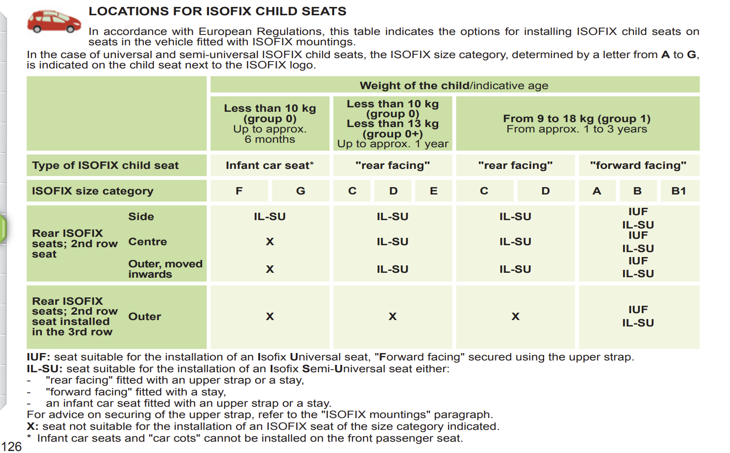

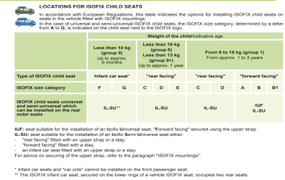

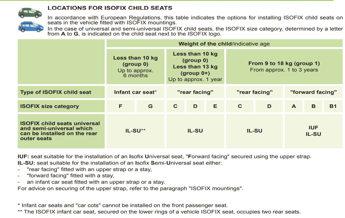

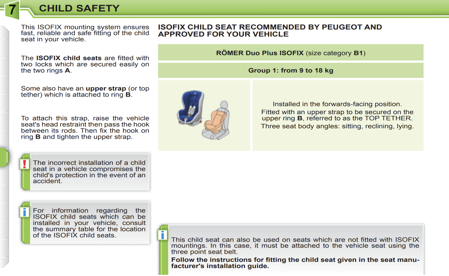

Andy, it's all on page 123 of your manual, relevant extracts below (click to zoom images). Note there are 2 rings at the bottom of the seat cushions and one top tether at the back of the seat. Remember these are intended for child seats.....
