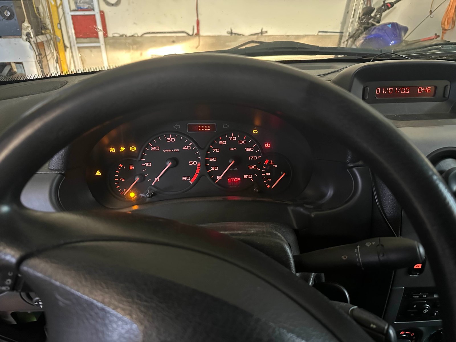

I have a problem with my berlingo 2006, all the lights in the speedometer lights up, and not any of the intruments works, the milage is only ---- and no km reading, i have changed the bsi, ecu, keybarrel, and the fusebox, and the speedometer, and the fault is still there, my guess is that a signal cable to the speedo is broken, anyone have a idea of what to check?
this is how the speedometer looks like, when am driving, and the hazzards is not working, nor do the central lock

What diagnostics to you run before changing parts? If so, what codes did you have?

just some engine codes, nothing else, thats why i am in the dark

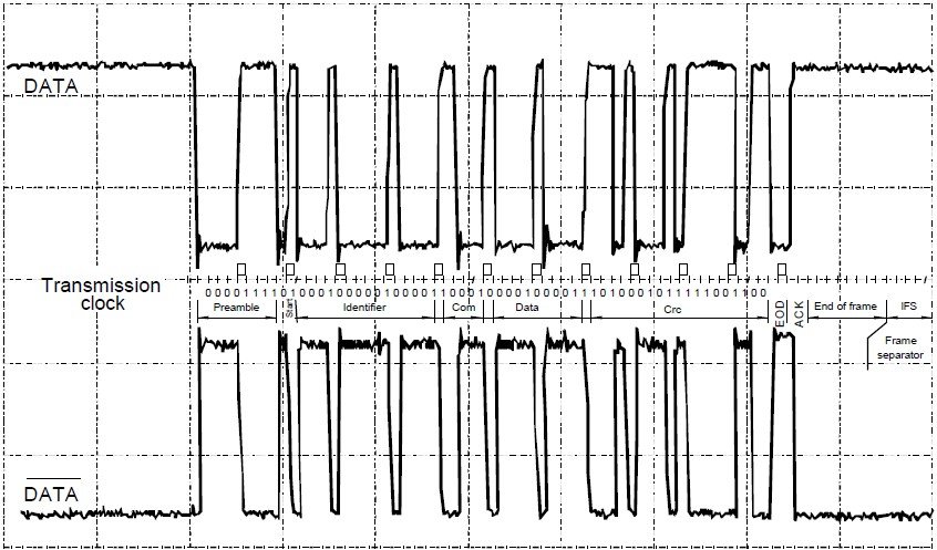

Citroen don t go by wire colours, they use wire codes printed along the length of the wire insulation every few CM.larsianer wrote: 26 Oct 2024, 05:31 i dont have a oscilloscope, but i can borrow one, about the Data & Data Wires, what color do they have, is there anyone that has the wiring scheme
You can pick up the VAN lines to scope either at the instrument panel 18 pin white connector pins 4 & 10 (wire codes 9004D & 9005D) or at he BSI 10 way black connector pins 8 & 10.
You should get a pattern like below, ideally with a 2 channel scope so you can see both at the same time, both signals should be a mirror image of each other.
