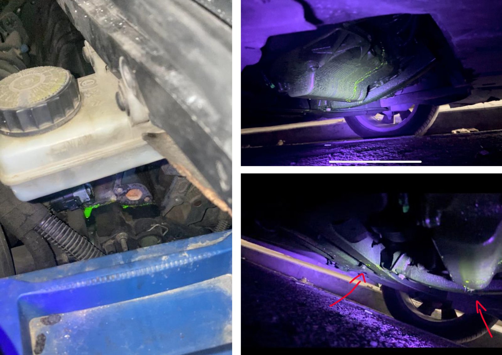

I am having this issue since i have bought this car some 20k km before and i just cant fix it.
I have recently replaced the thermostat housing and the coolant radiator and a few other minor things related to this issue and it still doesnt stop.
Shortly before the thermostat housing failed i used a fluorescent dye to identify the leak and now i have used it again (the green thingy that glows is teh water leak) but i feel like it is kinda damaging the coolant system.

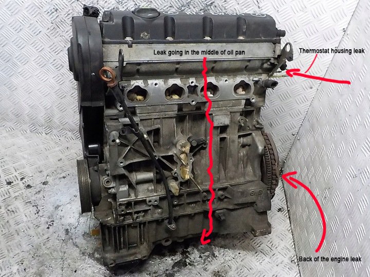

The bottom of engine is also covered in oil a lot.
Im not sure if it can be a failed head gasket (from coolant passage to outside and oil passage to outside) because the oil and water does not mix and i also do not have signs the coolant might be getting into the combustion chamber.
Regarding the temperature its almost ok expect in heavy traffic where it goes 4 bars and after fan working for like 30 seconds it goes back at 3.
Any advise would be appreciated
Thanks!

I have used a product like that before the thermostat housing blew and i feel like it didnt work that well perhaps even made things worse as i had to replace the radiator some time ago
