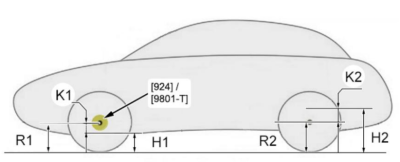

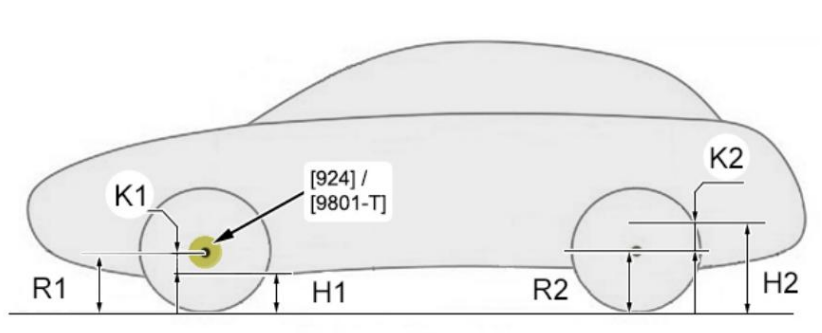

I believe the e-C4 axle data is the same as the non-electric version, translated here:
Legend:
"R1": Front wheel radius
"R2": Rear wheel radius
"H1": Measurement between the measuring area under the front cradle and the ground
"H2": Measurement between the measuring area under the rear spar and the ground
"K1": Distance between the wheel axle and the measuring area under the front cradle
"K2": Distance between the wheel axle and the measuring area under the rear side member
Checking the vehicle's front axle trim
NOTE: This trim measurement allows the front wheel alignment to be checked and adjusted without setting the reference trim.
Measure the front wheel radius "R1" using appropriate tools. Measure the front height "Z1" between the ground and the "Z1" zone using appropriate tools.
Calculate "K1" = "R1" - "H1" for the front.

Measure the radius of the front wheel "R1" using appropriate tools.
Calculate "H1" = "R1" - "K1" for the front
Measure the front height “H1” between the ground and the “Z1” area under the front cradle using appropriate tools.
Compress the front suspension until the calculated H1 value is obtained.
The height difference between the two sides of the front axle must be less than 10 mm
Rear Axle
Measure the radius of the rear wheel "R2" using appropriate tools.
Calculate "H2" = "R2" - "K2" for the rear.
Measure the rear height “H2” between the ground and the area “Z2” under the rear side member using appropriate tools.
Compress the rear suspension until the calculated H2 value is obtained.
The height difference between the two sides of the rear axle crossmember must be less than 10 mm.

Just how poor is the suspension design if you have to compress the suspension to a known datum to check the toe? I always knew independent suspension was dodgy as you get such peculiar tyre wear compared to the flat wear of a beam axle.
So I need to crawl around on the ground and measure the hub centre to the ground {(upper edge of rim to ground+lower edge of rim to ground)/2}, and then subtract the subframe to ground clearance, to give a K1 value, and then convert the K1 value to toe using the Parallélisme à l’essieu table.
As I measured 7.5' toe-in I need to check that k1 is currently between 120 and 130mm
I hope it doesn't rain tomorrow!

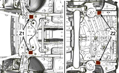

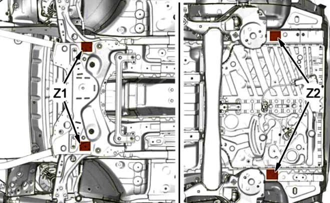

I've hit a snag-
It looks like a dog's back leg under there! It isn't even flat, the flange on the subframe is above the lower surface.
A 10mm error in measuring H1 is the entire tolerance on the alignment, and I have 3 measurements to make....
EDIT: taking measurements under the flange immediately beneath the lower control arm, I get 123mm for K1, which is as close as I am going to get to the reference value of 118mm, so my tracking is spot-on. (Subject to all the errors in distances, flatness of my surface and not checking for wheel run-out when I had the track gauges out.)
The reference value is probably the normal ride height of the car, you'd think the e-C4 would sit lower with the weight of the batteries and Z1 would be larger.
Where is the "Z1" area?Measure the front height “H1” between the ground and the “Z1” area under the front cradle using appropriate tools.

This is all I have. I assume there are no values for the rear as they are not adjustable. This is combined info for checking the suspension height too, but as you elude to - not really a DIY job to be honest...
Legend
"Z1": Measuring area under front cradle
Z2": Measuring area under the rear spar
Legend

Thanks, you replied whilst I was editing my post.
That red area is above the splash shield!
I measured from the thick flange right where there is a letter A, and my ride height is "near enough" the reference value.
DIY would be the way I think, I can't imagine that a tyre fitter is ever going to bother measuring and calculating the ride height, especially if you have to take the splash shield off.
I imagine they have one value- probably the reference value, and set it to that.
I'll ask when I get the new tyres, I just wanted to check myself that the tracking is ok before I go and they try to charge me a fortune for "laser alignment" if I don't need it.
