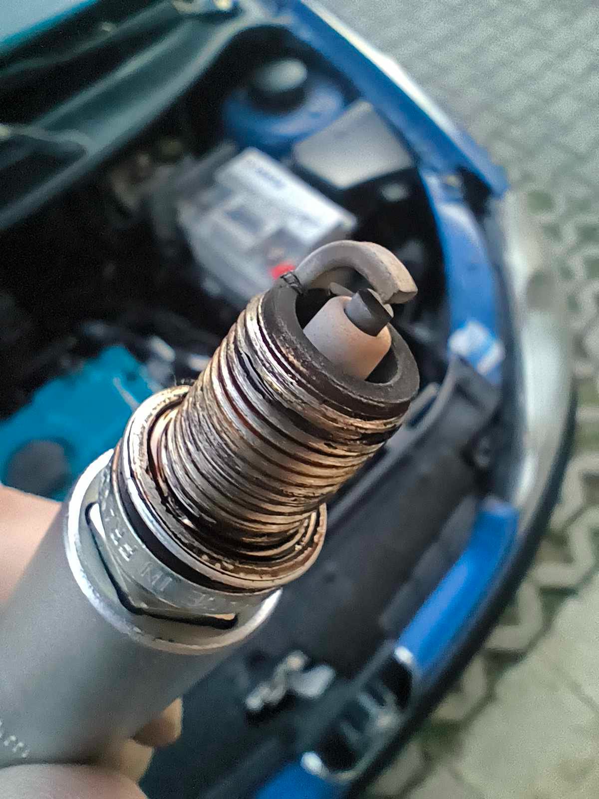

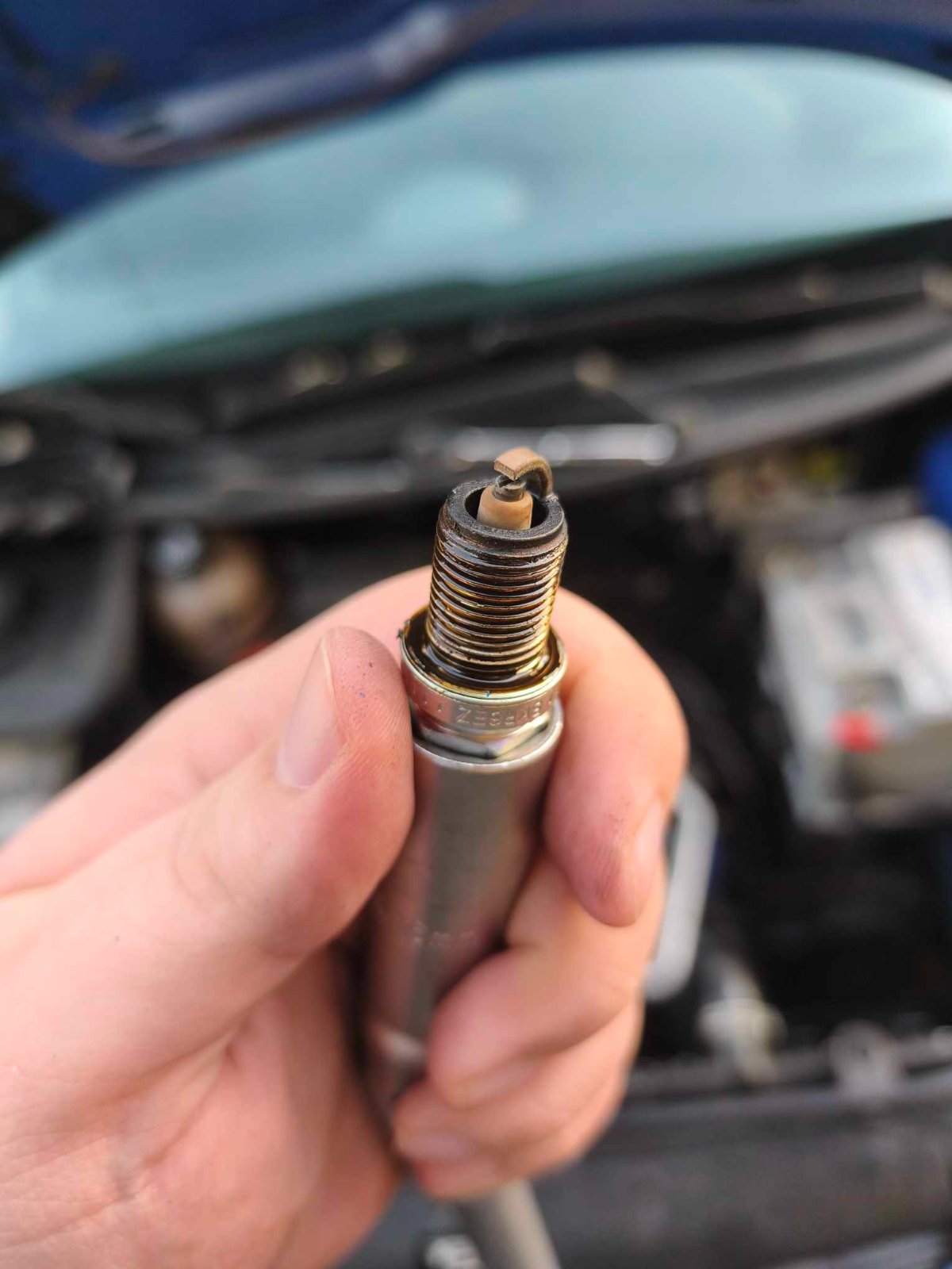

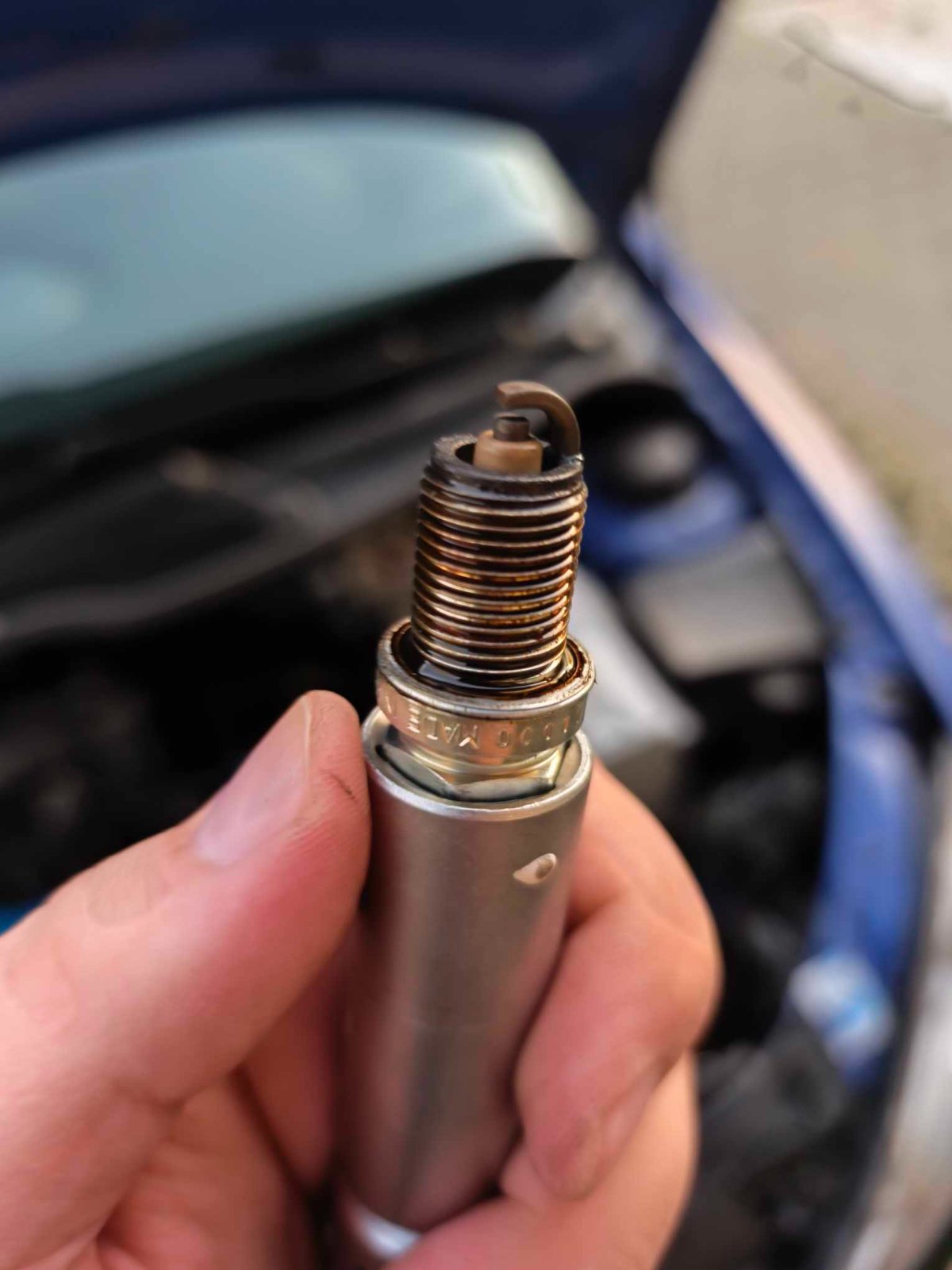

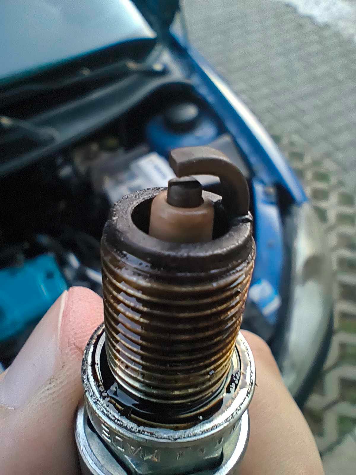

Next weekend I will try to measure the injectors if the resistance is ok and if o-rings on them are good. Today I didn't have much time so I wanted to check at least if some of the injectors were leaking or not. So I pulled out plugs to see if they are wet and 3 out of 4 plugs were oiled. But no sign of fuel. The oil level is constant so it's not leaking into the cylinder from the head. I think the oil could have poured to the sparkplug wells when I was setting the valve clearence. At least I hope that is the case because I really don't want to know how else it got there. The cover gasket was changed last year when I was doing headgasket job. So it's not from valve cover.
But seeing this I started to think if this isn't my problem origin. The oil might have been slowly seeping onto the plugs and saturating them. The problem only occured when the car was not driven for a while. So the oil had time to seep into the plug and then it was burned off during first few minutes of the ride. The problem was only happening during first few hundred meters and never after that. Could oil seeping into the plugs make the engine "cought" so it does not respond to the throttle?
On the pictures are the spark plugs. They are NGK 4619 around 5k kms old. I think the color of the plugs is ok?
Via live data I only saw O2 sensors (lambdas) throw bad data so I changed them both.

Looks like new idle control valve, cleaning whole throttle body and resseting learned parameter solved the problem. Two weeks after changing it the problem did not come back.
Oil problem was irrelevant to this. Oil was from when I was doing headgasket. After cleaning it, it never came back.
