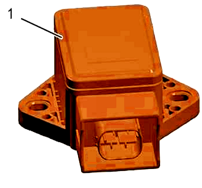

I’m having trouble finding this sensor getting mix reports between down the side of the drivers or passenger seats also under the gear stick panel do you have any idea where I will find it thank you

Best to pop your VIN up as there are multiple variants of these. Please post your VIN in full without spaces - it will be automatically masked from public view after submitting your post & will only be visible to staff.
If this is a Partner Utility vehicle (B9), then it will be located under the handbrake.
  • The gyrometer-accelerometer sensor is a piezo-electric sensor located under the handbrake.
  • The gyrometer-accelerometer sensor is fitted on the vehicle in such a way that the connector is opposite to the direction of travel of the vehicle.
