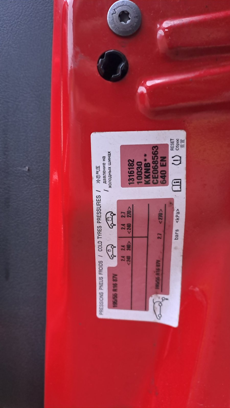

You have not said what engine you have or if it has stop start or not?
Sometimes the tyre pressure label has the original battery spec on it.
When looking at CCA there are different standards of CCA. Eg DIN, SAE, JIS, EN etc. Most PSA batteries are EN spec.

wheeler wrote: 21 Oct 2024, 13:50 Sometimes the tyre pressure label has the original battery spec on it.
As in the bottom line of the RH box in the photograph ... "640 EN". Good to know.

It would also say here it was AGM or EFB

Thanks. The information label on the door agrees with with 640A rating (photo in another post).
