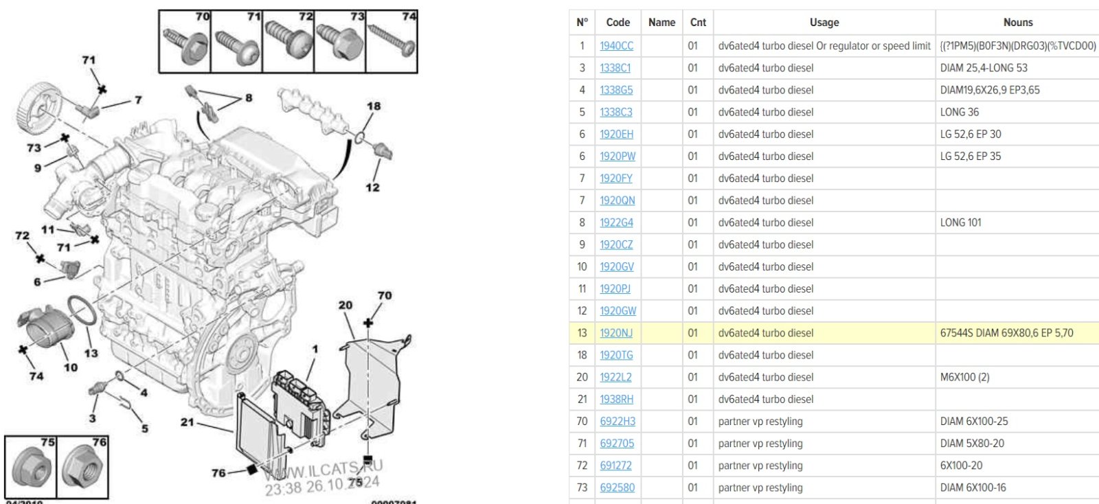

https://www.ilcats.ru/peugeot/?function ... anguage=en
I believe this is your engine.
I guess you ale looking for item no 13. There is the oem number and dimensions.

Vladimir1977 wrote: 26 Oct 2024, 22:02 https://www.ilcats.ru/peugeot/?function ... anguage=en
Thanks Vladimir!
I ended up buying a 65 x 5.7 o-ring after some measurements and that worked.
