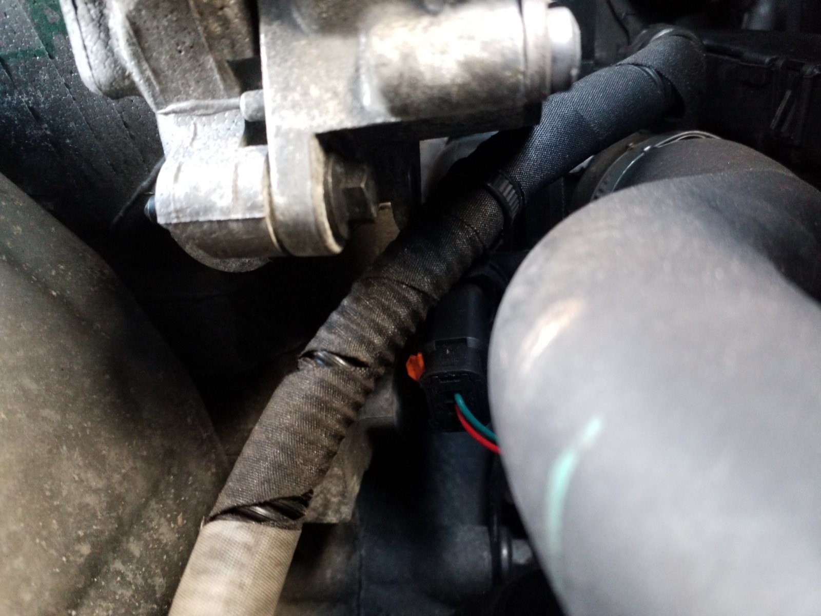

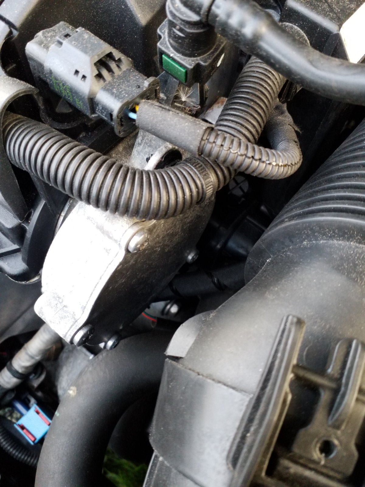

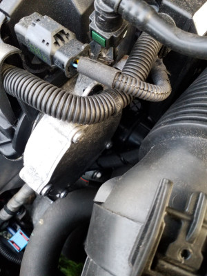

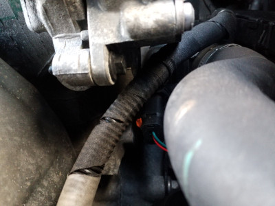

How do I tell if mine is the type of sensor fitted withing the thermostat housing.
I can see a sensor looking down and underneath and see a visible sensor going in to the housing which I could change easily but I am not sure if this is the correct one.
I have attached a photo if someone could possibly advise?
The fault comes on and off at irregular intervals but the car runs fine so I am a bit confused.
I appreciate any help anyone can offer because looking at some of the costs to get the housing replaced look very expensive.

Before replacing any parts I would use your code reader to look at the live data to see what temperature it thinks it is at. Then if it is not realistic it may suggest the sensor or its connector or wiring are at fault.
A search on P0016 comes back with the crank shaft and cam shaft sensors not matching so you may have written the wrong code down since this would not give a temperature warning.

You are quite correct,I have put wrong code like an idiot.
The code is P0116.
