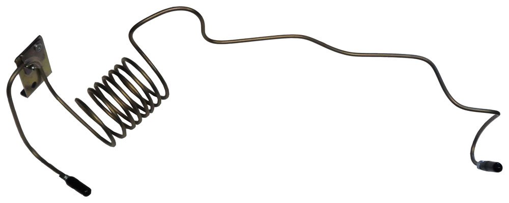

Re: Xantia Sx LHM leak.
Hi Sticky,
The LHM leak came from the coiled brake pipes, see pic of similar attached.
Mine was rusted through in places (26yr old pipework) and needed replacement.
Happy to keep my car going anyway as it's never let me down (in nearly 15 years) and you can't put a value on a lucky car.
Cheers for advice,
Steve
