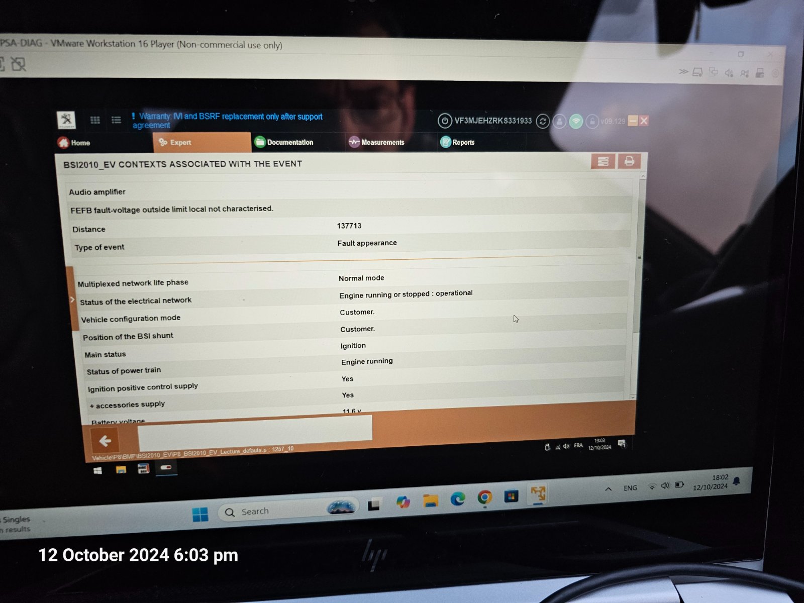

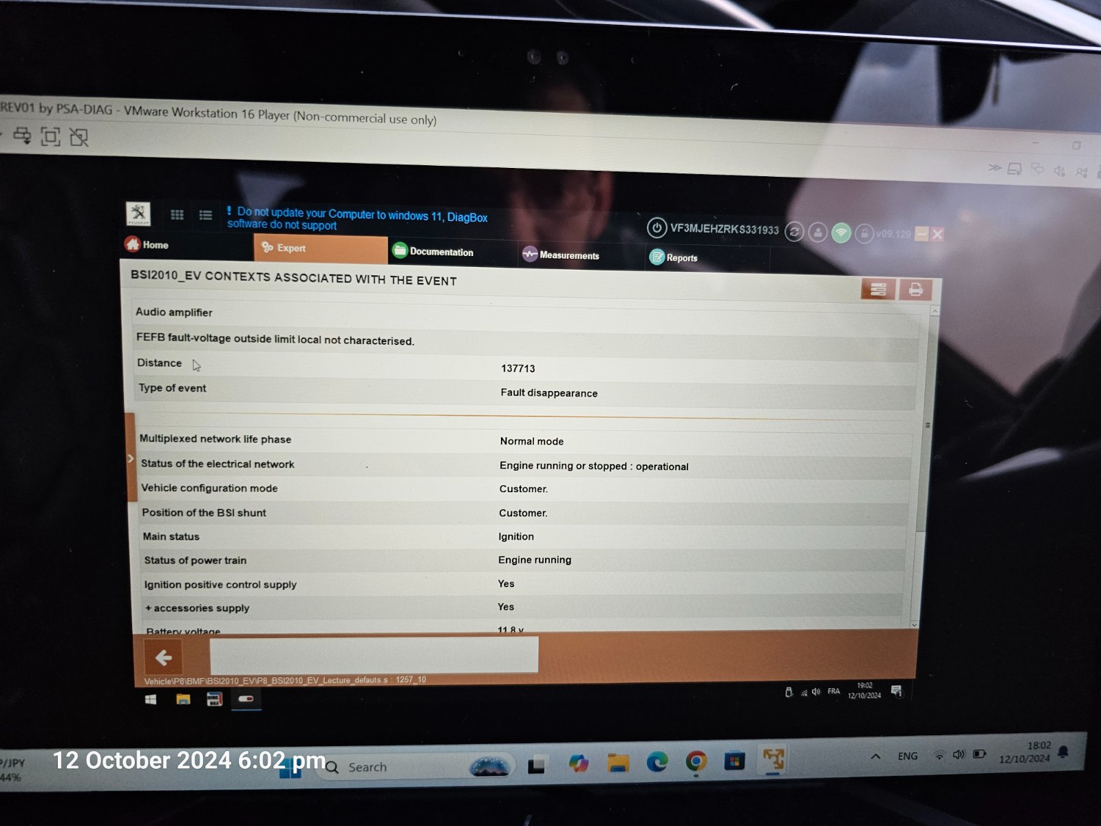

In my Diagbox the only fault I have connected to amplifier is "FEFB fault-voltage outside limit not characterised "(see attached photos for details).
Anyone experienced something similar or have any idea what that fault refers to? I noticed that battery voltage is around 11.6V when fault comes.Is that a normal voltage or it's a bit low and maybe that is the reason for the fault?
Battery SoH and SoC are around 60% and maybe it is going to end of its life.
Any help will be much appreciated.

Battery does seem low from what you have said. If it's 5 years or older, time for a change.

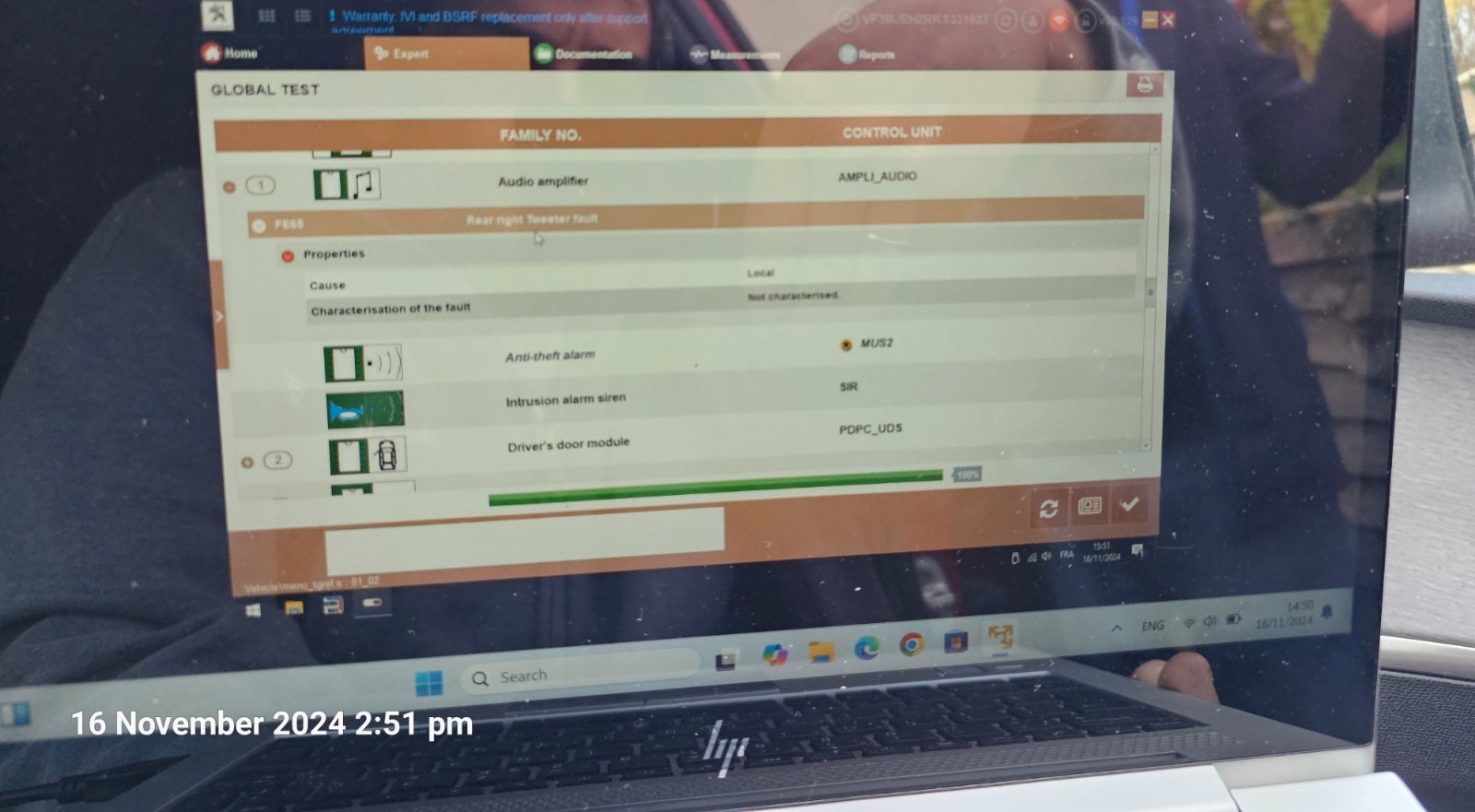

I think I have found the trouble maker. It was rear right tweeter triggering the fault. I got it when during the "silence " I connected Diagbox and the fault came out.
x 6957
