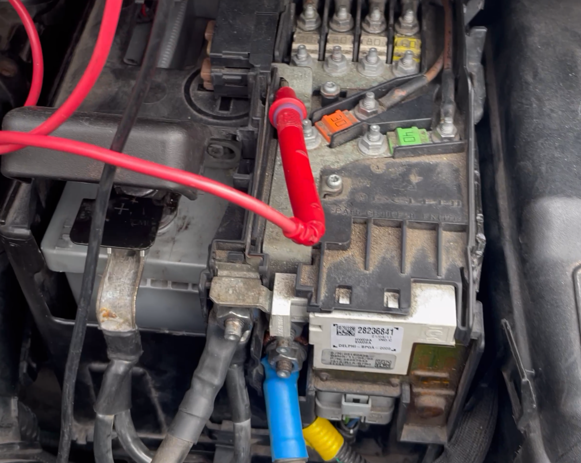

Battery showing 12.4v when not running. After looking at numerous posts I have ordered a alternator. I have also tried the mod of bridging the "BPGA" as shown in attached pics, as shown there was no change in voltage.

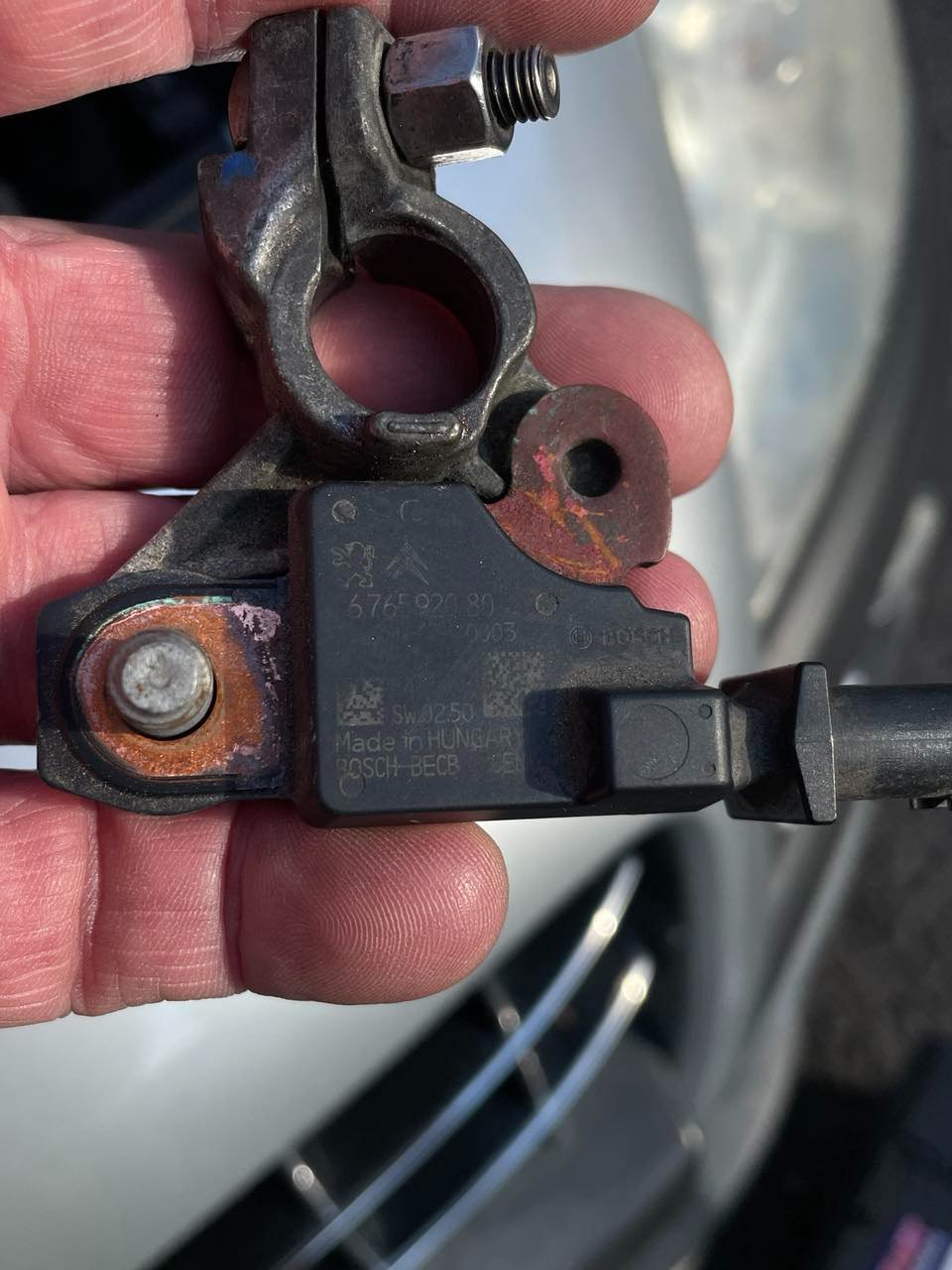

Going to have a go at replacing alternator today, battery been on charge overnight and fitted new BPGA (do I need to config new BPGA in Diagbox ?). Would it be a good idea to order a new negative lead "Battery State of Charge" unit? I have had my one off whilst cleaning all battery connections, copied part number (9676592080,pic attached) but I can only find "used" ones and new ones that do not have same part number. If anyone has a replacement/alternative part number suitable it would be appreciated.
