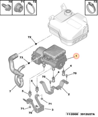

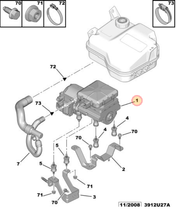

Greg, in future, please post your official part number requests on the dedicated Forum Here to ensure your post won't be overlooked or not seen by staff.
The pump is not sold separately, it is sold as part of the complete Hydraulic interface:
(1) Suspension Hydraulic Block (Unconfigured - requires configuring with Diagbox), part: 5277N8, £2011.67
Suspension Block (Standard Exchange part - requires configuring), part: 1680917280, £1289.92

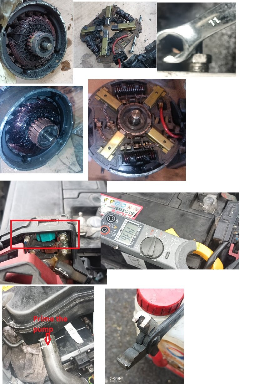

Thank you for your advice.
I have good news: I was able to fix the issue at no cost except for my time. It was a relatively straightforward task, although quite messy.
The problem was caused by an excessive amount of oil and graphite mixture inside the motor. After cleaning the interior and sanding the commutator, everything returned to normal.
Here are the results of my careful motor examination:
Motor Electrical Measurements:
Resistance between commutator slots: 0.3 Ohms
Inductance between commutator slots: 55 uH
Resistance of commutator to motor body: >Megaohms
Motor Current After Repair:
Free run (no pressure built up): 4 Amps
Low to 1st position: 10 Amps
1st to 2nd position: 15 Amps
3rd position: 20 Amps
These measurements can be used as a reference to assess the health of a similar motor/pump.
It's worth noting that after the repair, it took approximately 10 minutes for the pump to lift the car. I primed the pump by adding a small amount of oil to the oil supply pipe before reconnecting it to the tank.When the pump was running and there were no signs of the car lifting, I decided to pressurize the tank by covering the entry by hand and using the air gun observing a slight tank swelling. After a few minutes, the current started to increase, and the car began to lift.

Excellent news and yes, that's the way that many pumps can be repaired relatively easily as long as they are done before the 40a maxi fuse blows too many times - when it blows it's a sure sign that the pump is contaminated.
To re-prime the pump you need to apply 0.5psi pressure to the tank (which you have done). Leaving the pump running without pressure can burn it up although the BSI does have a timer built in to prevent this from happening (allegedly).
